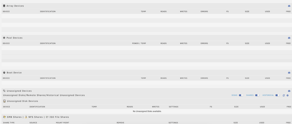

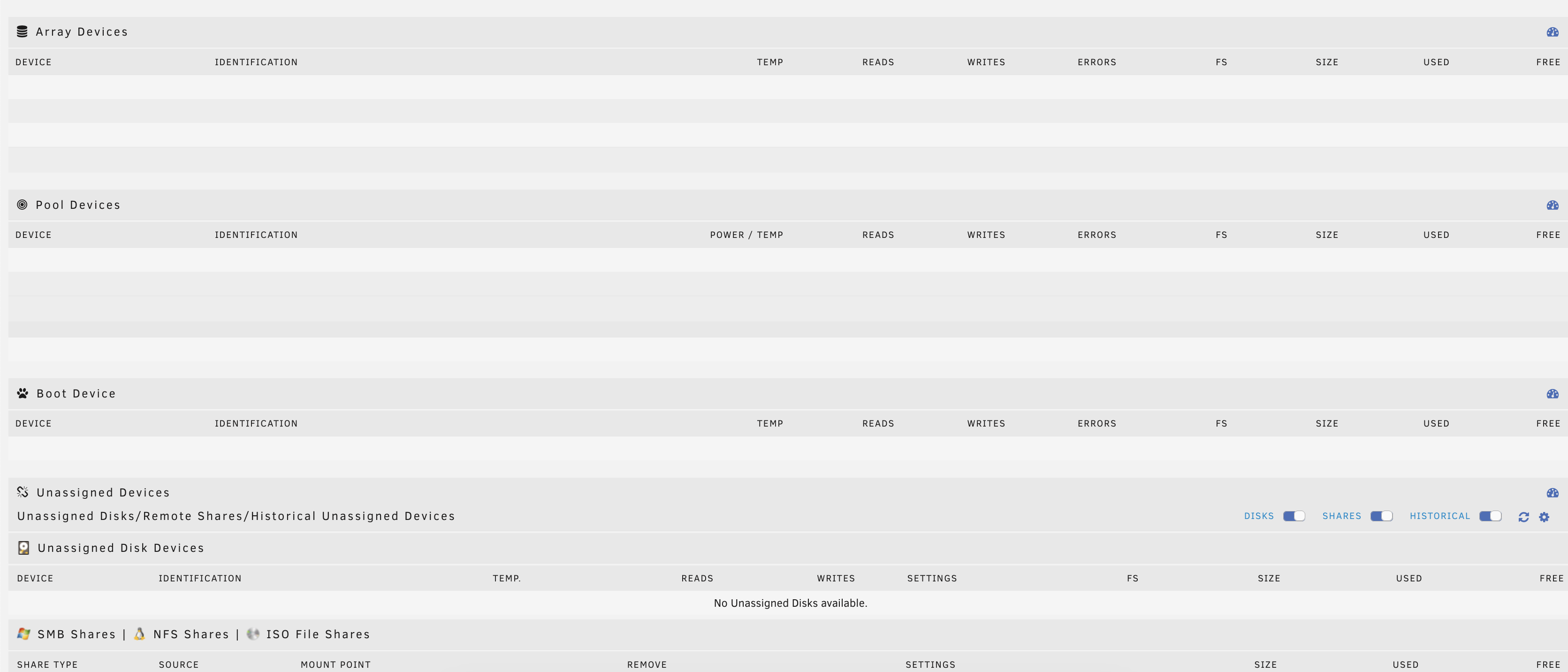

Reigniting this because im getting weirder and weirder symptoms. the latest is that the docker page only shows 0% cpu usage for everything and all my graphs and tables have disappeared.
This is typically just a display problem, try a different browser, or just reboot.
