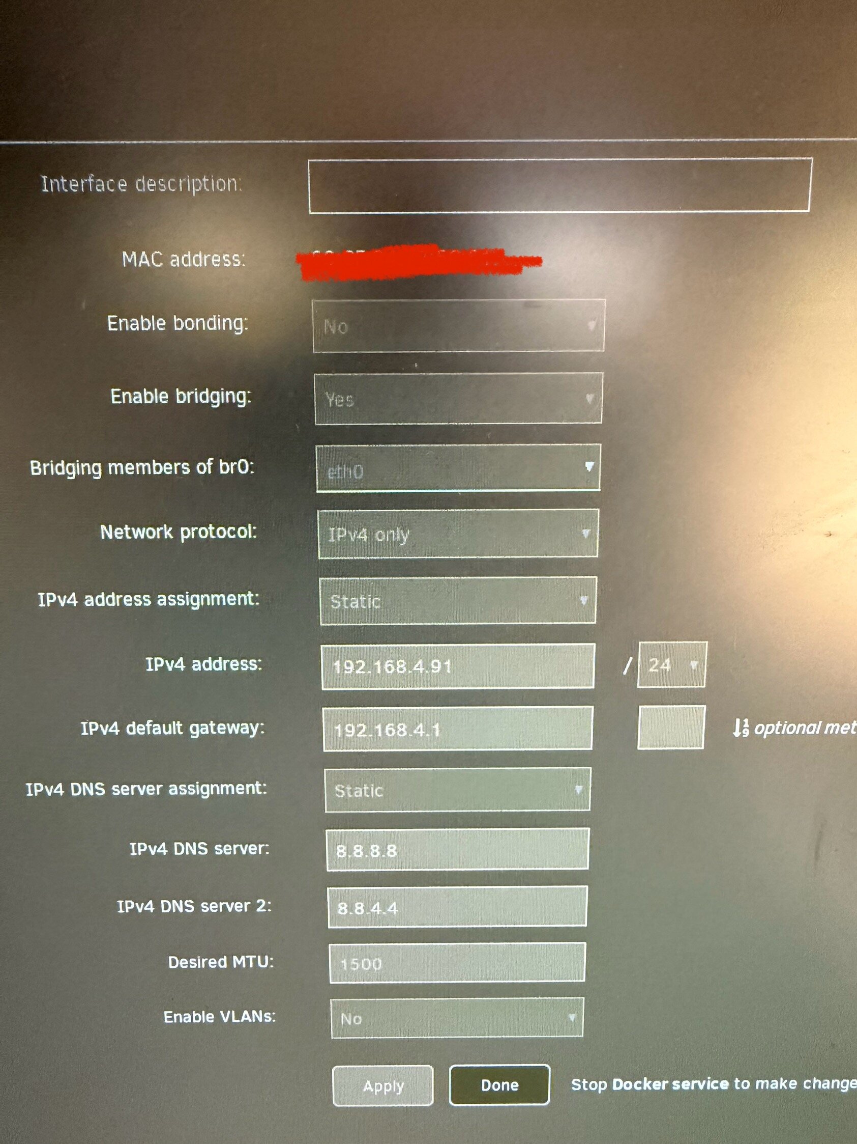

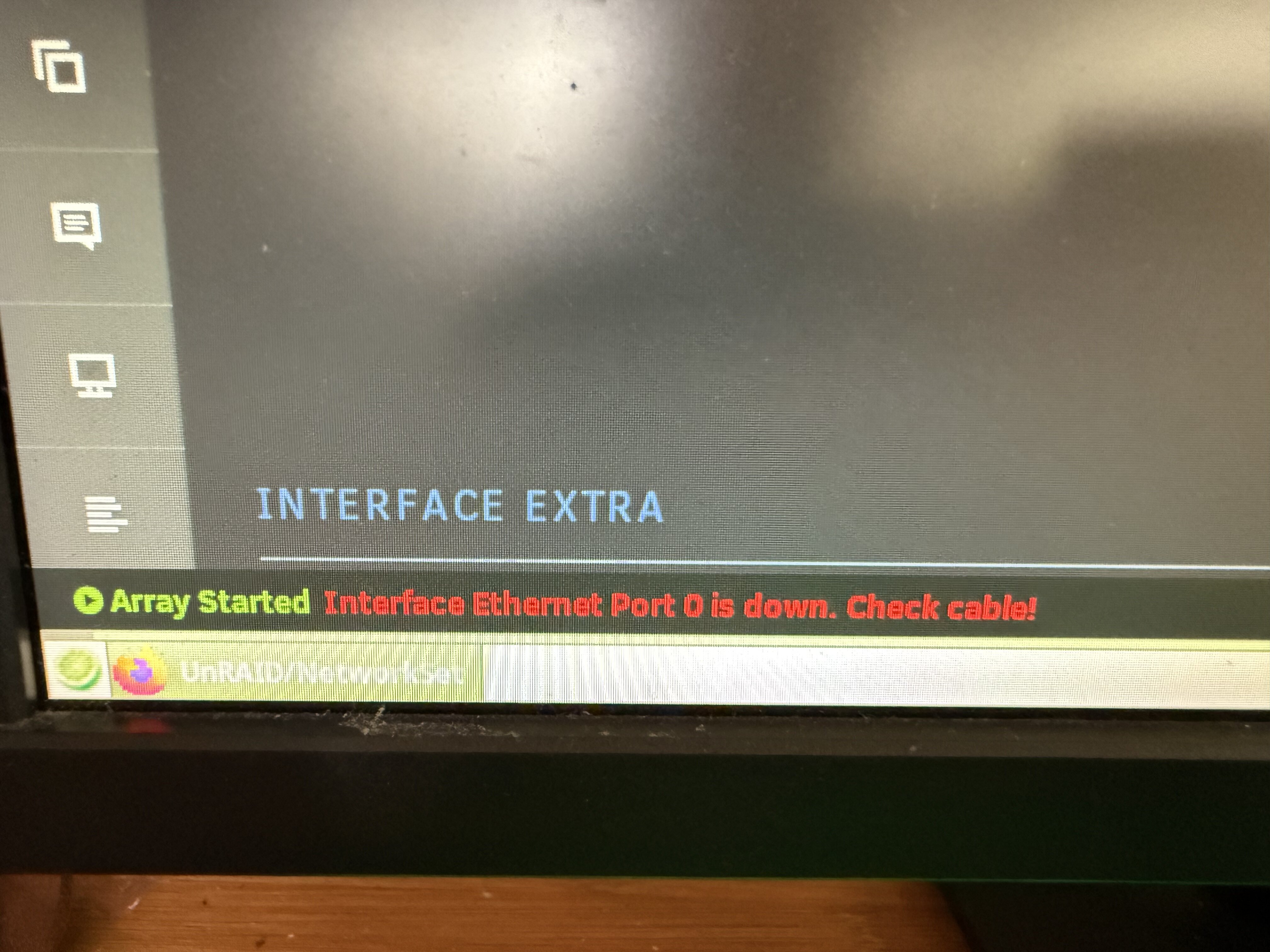

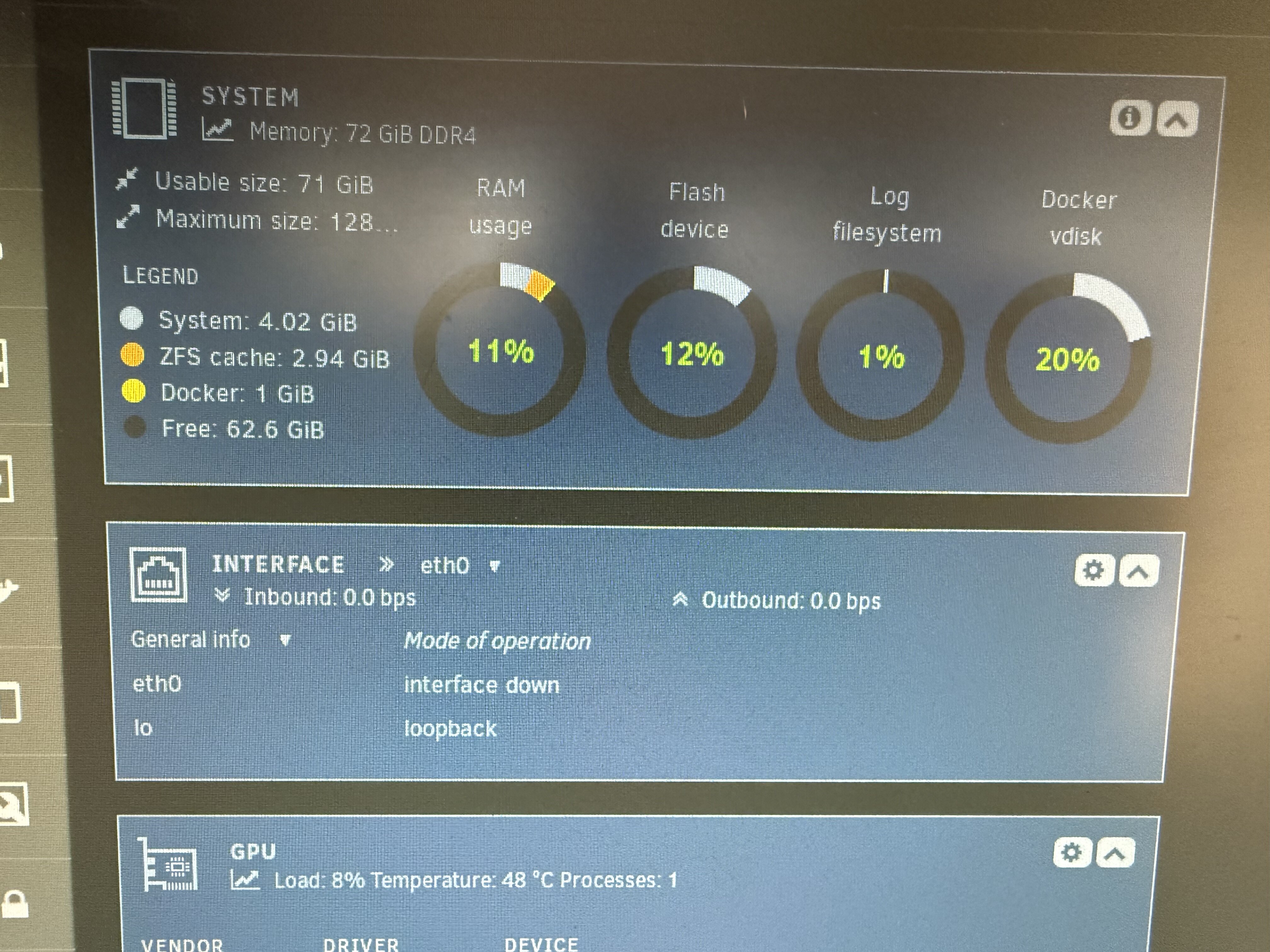

Hey all, I have an Ethernet issue that I can’t figure out. Server was working fine last night, then I get up this morning and it has “Interface Ethernet Port 0 is down. Check cable”. I tried a different cable, tried a different port on the router, no luck. I tried a usb to Ethernet adapter that had successfully used before and no luck with that either. None of the lights on the Ethernet port light up, both on the original mobo Ethernet port or the usb Ethernet adapter. Any ideas or help? I think I attached the diagnostic file on here (first time posting).
