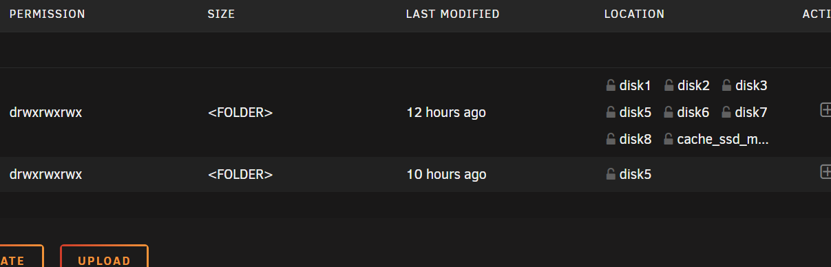

The data folder is where the media files are.  When I open data in File Manager, these are the subfolders (data is the top one):

As I've been looking deeper, the files that are on cache_ssd_mirror in the data share are not dupes and I need to move them off somehow.  Last  night I:
  • Opened cache_ssd_mirror in File Manager
  • Selected the data folder
  • Tried to Copy it to a different folder NOT under the data share (/mnt/user/data) elsewhere on the array (/mnt/user/newfolder)
  • Got an "Invalid Target" message.
I do have a mobile drive dock that I'm currently copying the files over to.  After that's complete, I just need to be able to delete them from cache_ssd_mirror and put them back on the array without messing something up.  Is it as simple as that - delete them from cache_ssd_mirror, then copy them from the mobile drive back to the data share on the array?
