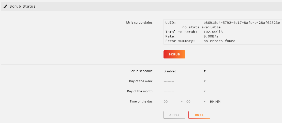

you may need to re import the btrfs volume...
Release notes:
https://docs.unraid.net/unraid-os/release-notes/7.0.0/#general-pool-issues
v6 didn't check or write the config correctly and this may be the culprit...
I would recommend stopping all dockers and go to main click on the disk and run a scrub and smart test.
otherwise, this is early sings of disk failure or improper docker storage configuration.
