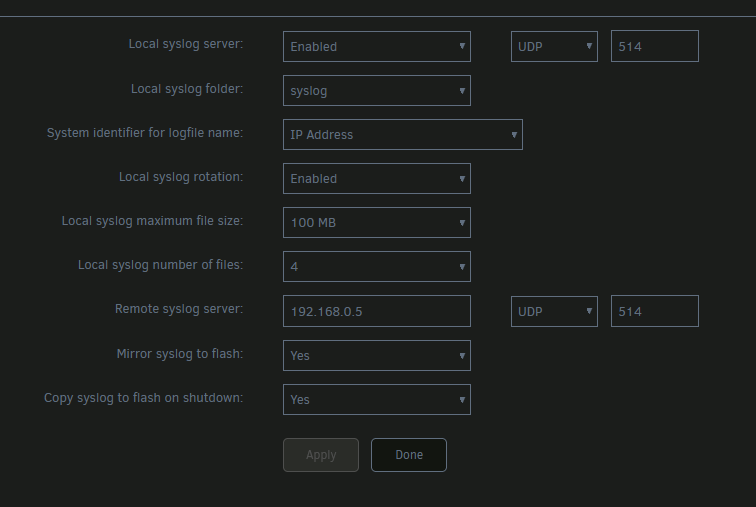

You need to set the local server IP on the "Remote syslog server" field, then apply and see if the error goes away.

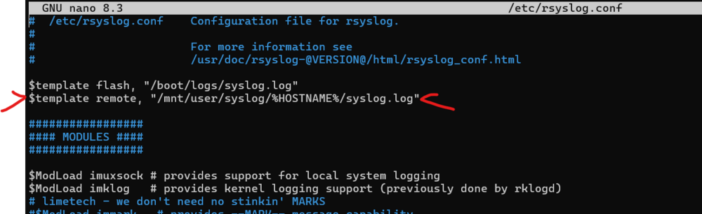

it doesn't behave differently. here are the changes (set IP and also enabled mirror to flash) i made and checked immediately after save.
root@SERVER:~# rsyslogd -N1
rsyslogd: version 8.2102.0, config validation run (level 1), master config /etc/rsyslog.conf
rsyslogd:  Could not find template 1 'remote' - action disabled [v8.2102.0 try https://www.rsyslog.com/e/3003 ]
rsyslogd: error during parsing file /etc/rsyslog.conf, on or before line 132: errors occured in file '/etc/rsyslog.conf' around line 132 [v8.2102.0 try https://www.rsyslog.com/e/2207 ]

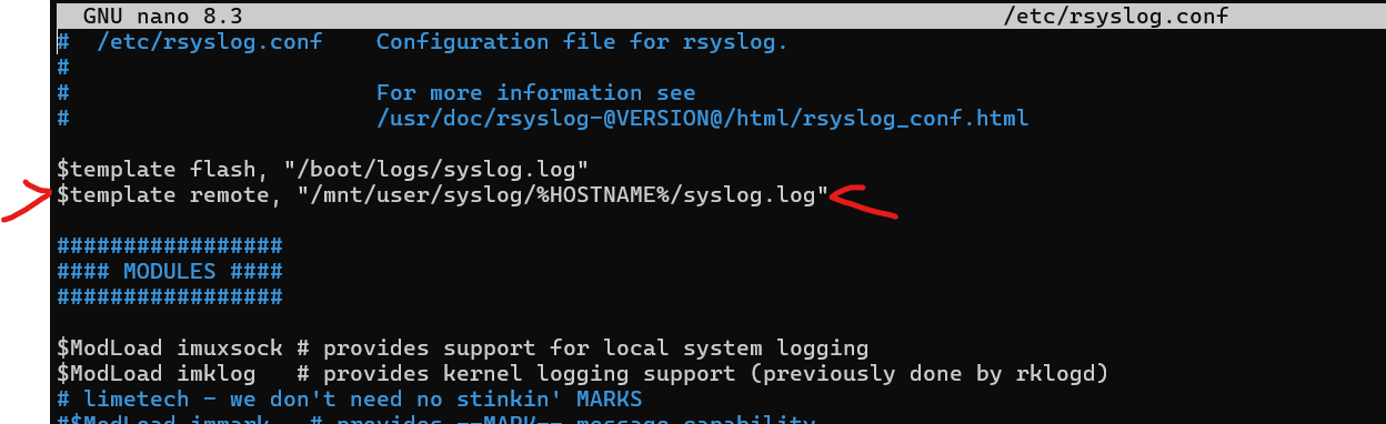

i have to go and add the template for remote manually and restart the process.image.thumb.png.ecbb2a620f5027af32d9b869d051a3de.png

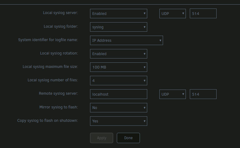

i went back to these settings on syslog server until i can figure out the crashing which is a primary concern for me.
Now that i have my server running stable again, i am coming back to this and cannot figure this out. i have syslog server completely disabled at this point, but still fix common problems reports that syslog is being mirrored to flash.
here's what rsyslog.conf looks like after i save the above config.
