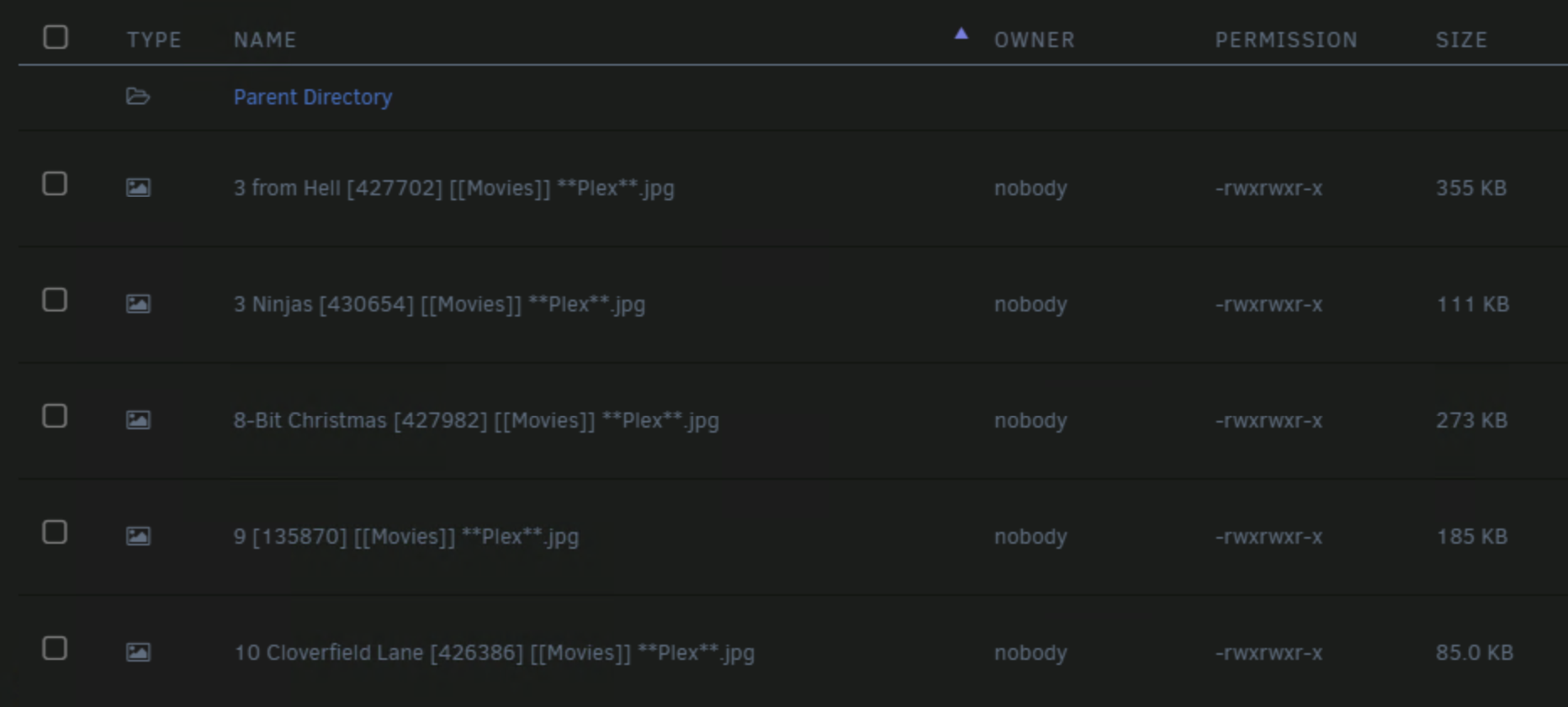

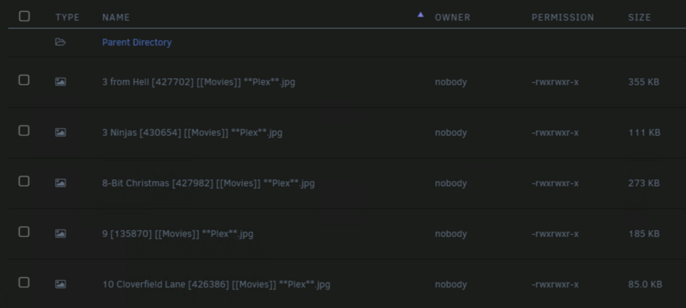

Invalid Path only 1 folder in the share

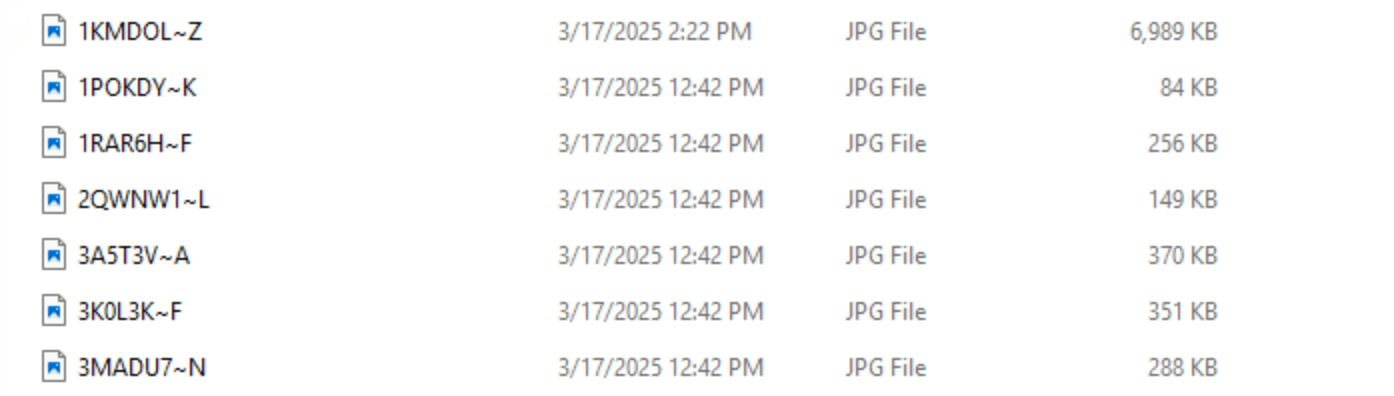

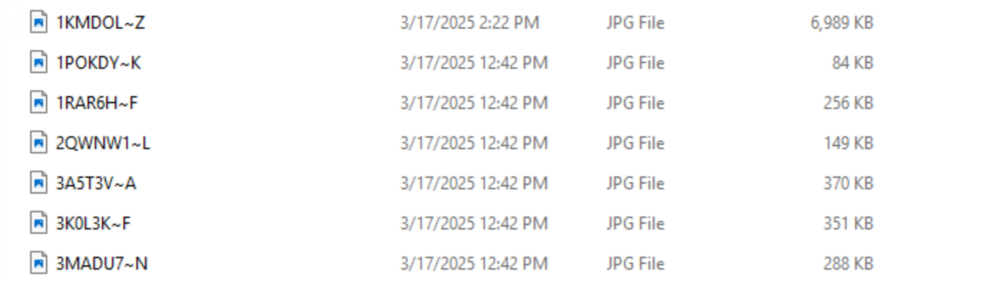

I have tried matching owner and permissions as other folders that work fine but if you look at the attached sreenshots the files in the SMB share do not even present the same as in the unraid WebUI.
I am at a loss as to why.
What are you using to "present" them?
Windows does not allow * in filenames.
Just windows explorer SMB share.
If i go up and into another folder in appdata everythign is normal.
4 minutes ago, trurl said:
that would explain it, i will reach out to the DEV about possibly changing the back end to not format them that way.
