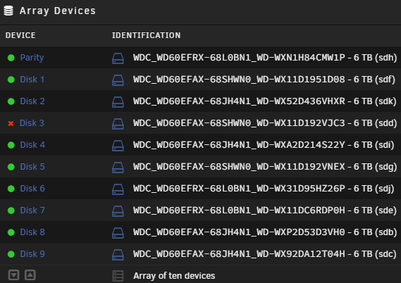

Hello all,

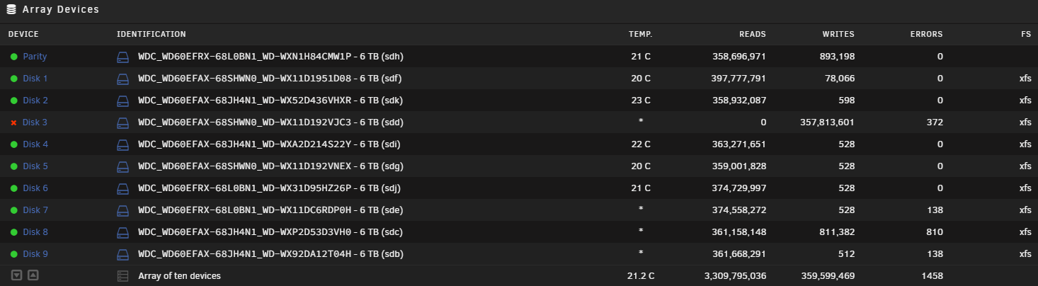

I booted up by unraid server last week to find Disk 3 disabled.

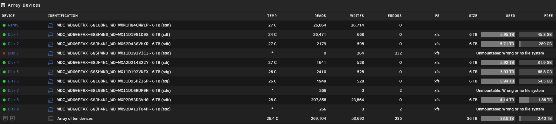

Upon stopping the array, removing the disk, rebooting the server, mounting again the missing disk and rebooting, the sever reports Disk 3 as "Unmountable: Wrong or missing file system", but now Disk 7 and 9, although mounted and running show the same info.
After rebooting the server again, Disk 3 is again disabled and Disk 7 & 9 are again mounted and running without the previous error.
At the time I can't re-mount Disk 3 and try to rebuild it.
I 've uploaded the diagnostics when the server starts, as well as the diagnostics after trying to re-mount Disk 3 and getting some FS errors for Disks 7 & 9 too.
Any help would be much appreciated.

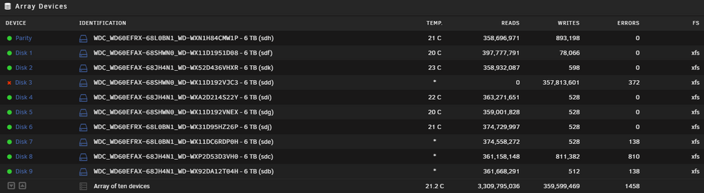

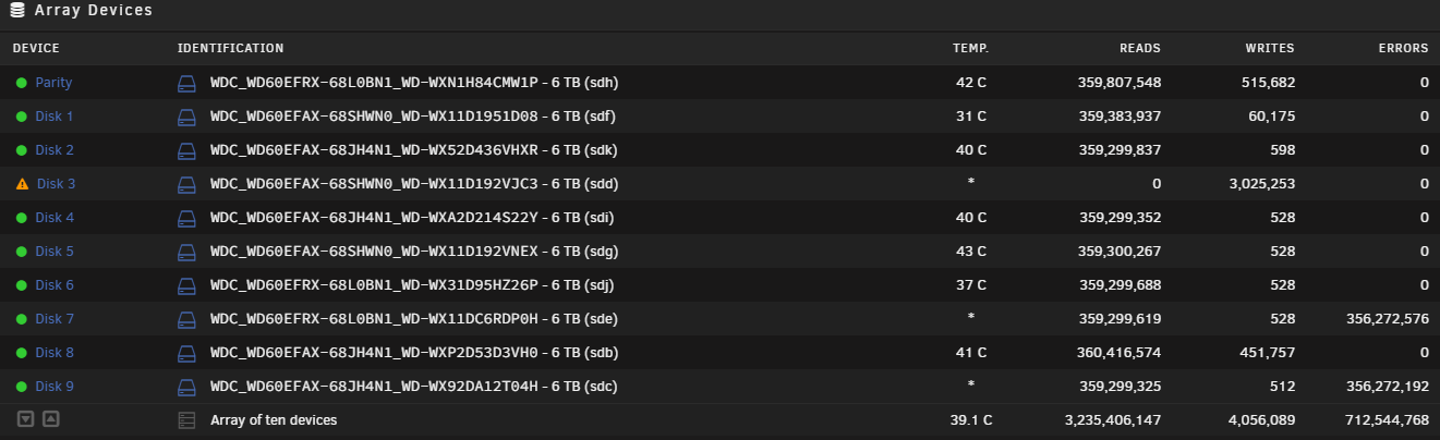

I returned home, checked the progress, it looks like there are other issues now.
Disk 3 stopped writing, Disks 7 & 9 (which also reported issues when I was trying to mount Disk 3 with the problematic FS but were ok after each array restart), are now showing errors while participating in the rebuild.
Should I stop the rebuild and check Disks 7 & 9 FS status too?
tower-diagnostics-20250319-2108.zip
You cannot rebuild multiple disks with single parity, could be a power/connection issue with disks 7 and 9, or the controller, since it's Marvell, if you don't have another controller, try replacing the cables and then try to rebuild again.

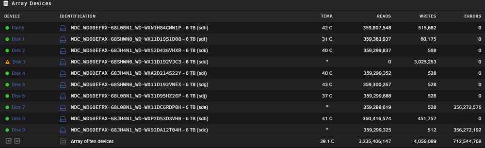

I replaced one cable that was old, the others had new cables (installed ~3 years ago). The PSU was also replaced ~3 years ago.
Disks 3, 7 and 9 where on the same PCI SATA controller, I moved them all on the second PCI SATA controller that had Disk 8 connected on it and started over the rebuild.
The controllers are 2x Digitus PCI SATA with 4 SATA connectors each, which I have them installed for many years now. There are no more free SATA connectors available except the non-used controller that had 3, 7 & 9 on it.
Looks like 3, 7, 9 have all disconnected. Nothing to indicate any need filesystem repair, but you should stop rebuild and fix connections.

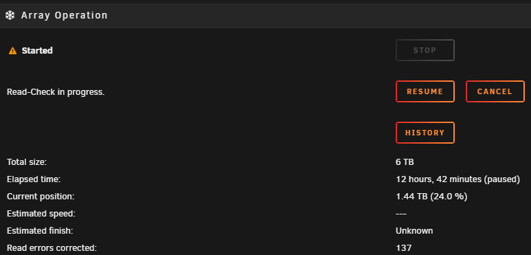

I checked its status today, the operation paused after 12 hours and at 24%, Disk 3 went to Disabled status. I will need to cancel the paused operation and try something new.
I am attaching the latest info.
