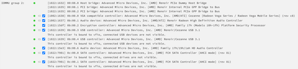

I'm running Unraid 7.0.0 and have a Ryzen 7 5700G CPU, where I was hoping to make use of the integrated graphics in a Windows virtual machine. Here's what my IOMMU grouping looks like, and convinced myself that this was safe enough to do and wouldn't affect, for example, array hard disks. List of devices in IOMMU group 2, for hopefully trying to get iGPU passthrough to a VM

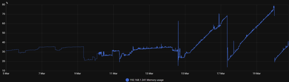

On Friday 14th March, I bound this group to VFIO and did a reboot on the system. I didn't realise at the time, but after this point the memory usage started to increase (see the output from the Glances Docker container that is fed into a separate Home Assistant instance below). By coincidence, I ended up doing another reboot on 17th which, which is where you can see the sharp drop in RAM usage. There's 64GB of memory in my server so it's actually using quite a lot -- or at least much more than my system usually does. I never did manage to get the GPU pass-through to work, so there was no additional RAM usage on that new VM.
 RAM usage graph over time
Then, on Wednesday 19th, three weird things happened (at the peak of RAM usage in graph above):

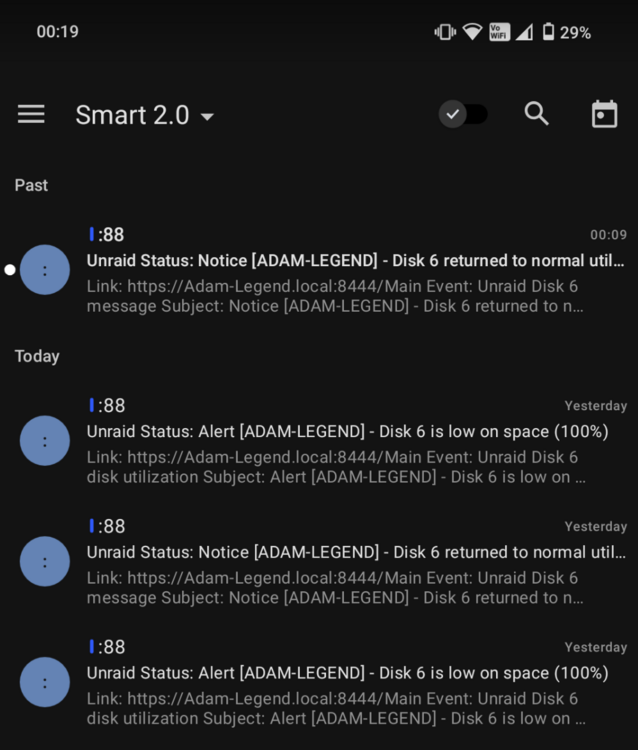

  • Had a flurry of emails over the course of 10-or-so minutes on a relatively newly-installed disk to say that disk6 was 100% full, despite it being more like 50% 4 emails in my inbox showing that disk usage had reached 100%, then cleared, then 100%, and cleared again
