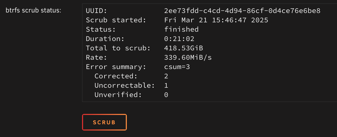

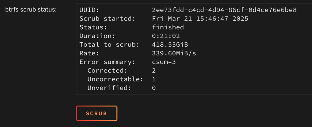

@JorgeB How can I fix this Uncorrectable error?Zrzutekranu2025-03-21o16_07_53.thumb.png.25d21cd88eb85fda32a58cba6e04ecef.png
You will need to delete the affected file or restore from a backup, it should be listed in the syslog during the scrub.

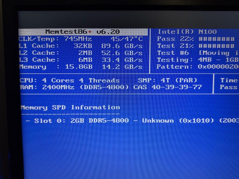

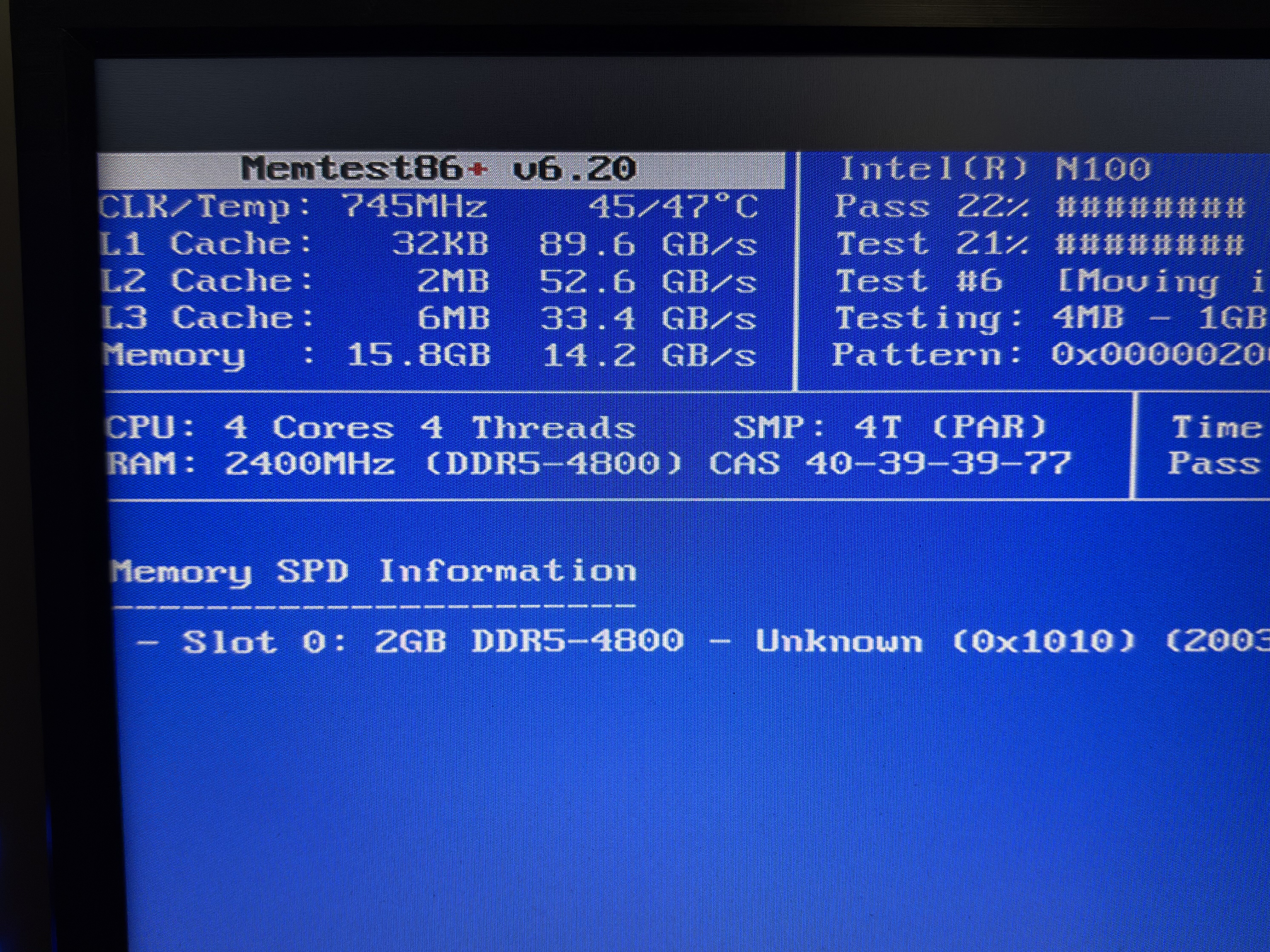

@JorgeBafter running memtest for about 20 minutes server restart (happen twice already), does it mean I need to replace memory? Can't see any errors before restart because it happen suddenly.
Server restarting on its own is almost always hardware, but necessarily RAM, if you have multiple DIMMs try running the test with one at a time.
@JorgeB I have a time machine share and every time macOS creates a backup, scrub finds an Uncorrectable error in that share. I have tried to remove everything from the time machine share I created a new backup and again Uncorrectable error has been discovered by scrub command. Is something wrong with time machine backup or my SSD/ram?
also memory SPD shows only 2GB instead of 16IMG_9403.thumb.jpeg.c767cd0f1ebe2eed96e17f7dd15d60cc.jpeg

i know i need to replace RAM because memtest shows me a few errors before server restart but could it be related or I need to replace SSD too?
Edited by Vitek
Any RAM error is serious, and can cause all sorts of unpredictable behaviour.  You need to get this resolved and then see if you are still getting the issue with the time machine share.
Ok I will do scrub once I replace RAM
If you have RAM errors, you need to replace that now, you should never try to use the server with known bad RAM.
