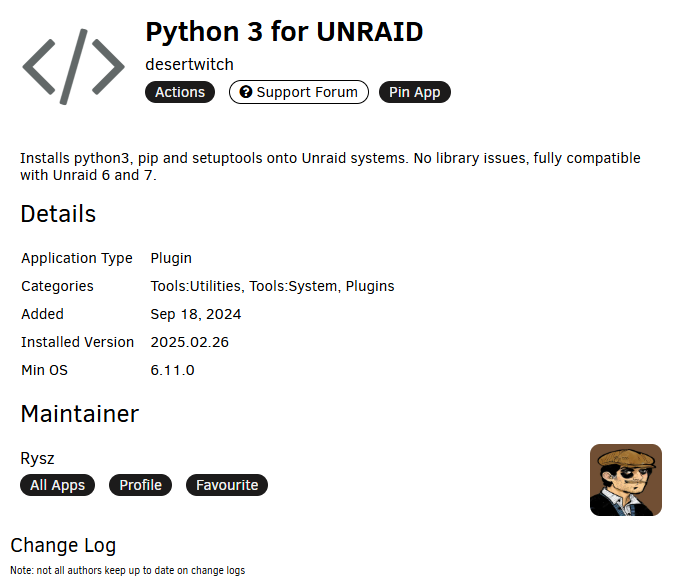

as something is clearly needed for python that you have on the system, such as a extra program instaled or other script. I would recommend installing this plugin to add python and python support to unraid.
as you have some nerdpack installs and something from dev pack the error you are seeing is most likly caused by missing dependant applicaitons
