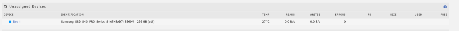

So to clarify the Samsung 840 Pro that is currently unassigned is the OLD drive. The drive currently assigned as Cache 2, Kingston 2 TB, is the NEW drive.
What I've done so far is the following
1. I added the new drive to the pool and let them go through the balance process.
2. When that was done I stopped the array and unassigned the old Samsung 840 Pro.
3. I then started the array again and waited a while before stopping the array to change back to 1 slot.
This is pretty much where I am now. As it is currently I can not start the array and can not change back to 1 slot.
Should I "move" the new drive to the first position sort of like this and then click "Yes, I Want to do this"?
Watching the video you posted, I guess that is the process I should've used instead of this one which at first glance seemed more straight forward...
