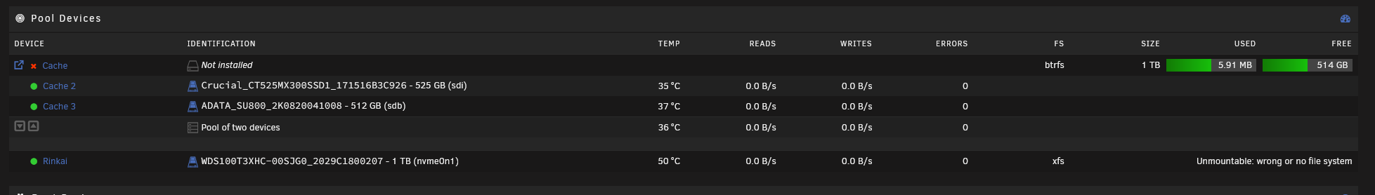

Ok I managed to boot to the gui by taking cache.cfg out of the usb drive.
The cache drives were empty so no issue here but as I tried recreating 2 pools I still get an error message concerning the nvme drive as you can see in the pic, how can I just remove it from that pool and have just cache 1 and 2, after all before starting the array, I made sure to place that disk in another pool.
Could it be due to the fact that all 3 disks were initially configured in raid1 so 'they keep looking for each other' in simple words?
At this point all I want is use the 2 500gb drives together and the nvme by itself for downloads.
Let me know if you have any clue.

There's a bug with 7.0.x when removing btrfs pool devices, you need to finish manually, please post the current diags with the array started.
