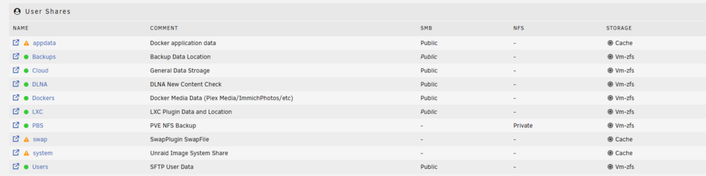

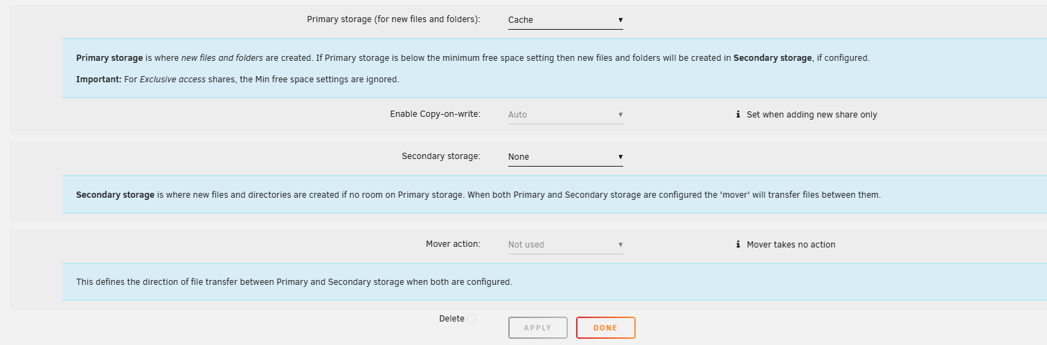

what are your share settings...
one of them is set incorrectly and has data between disks.
image.thumb.png.066338224f9528b3be9c9066ea9e19fd.pngimage.thumb.png.63a08be68a9771cbafb03934c0668d72.png

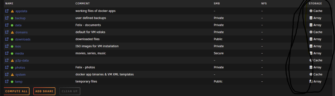

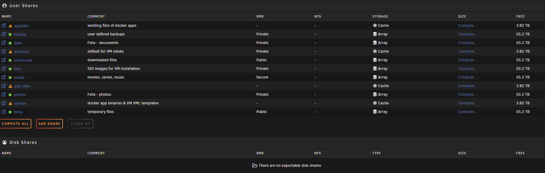

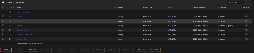

I don't believe so. They are all set to either cache or array.

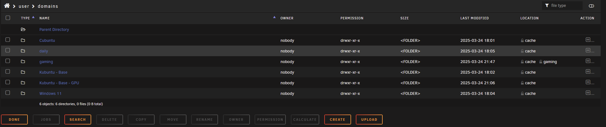

I have created a "domains" folder though on the gaming pool and I currently believe that this is what was causing "check for common problem" to trigger the error. This is still there. As you can see above in the shares it clearly says cache for domains. but when I navigate down the folder structure then I see the domain folder from the gaming pool for some reason. and this one also has a double tag, cache and gaming. This does not make much sense to me.

I have cleaned up the directory structure and I have no duplicate files anymore. However the system does not let me delete the /domains/gaming on the cache pool and also not /domains on the gaming pool.
None of these folders still contain any vdisks, They are empty.
Neither with dynamix nor via cli can I do anything with these folders, I tried deleting,  moving and renaming them. Nothing happnes.
You will need to go to settings > VM
and go to setting > docker
Disable Both...
Your shares tab shows the data is set to the cache disk
You need fixed the share and set it to store data on the mount gaming zfs pool...
then we can open mc and move them to where we want to go as your fighitng mover and where new file are told to go.
you may alos need to stop the array to kill any active disk task once you disable VMs and Dockers...
I alkso recomend turn off any docker and VM autostart as after you fix the data we may ned to doublecheck vm and docker paths to mathc the correct location.

Why would I have to set gaming as a secondary storage? the vms shall remain on the cache. except for the gaming vm which is on the gaming pool. So basically all files are where they should be.
