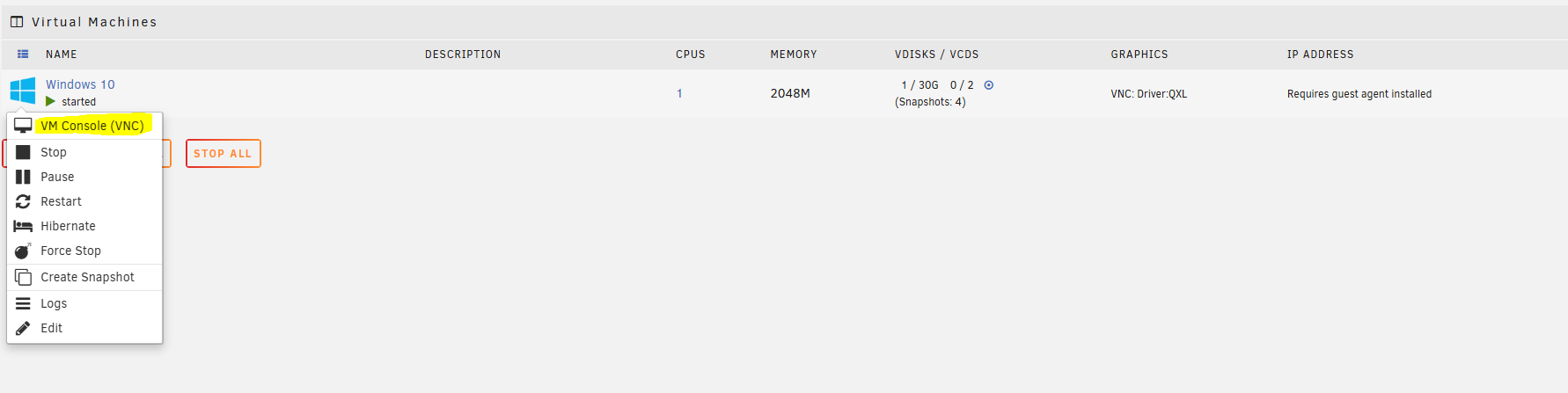

i tried to install my first VM on unraid. it looks like the VM was started sucessfully, but when i try to connect to the Machine i get the following error:
No IP, guest agent not installed

Like mentioned, that is not required to access the VM, use VNC:
For me it looks like this if i try to connect to the VM:
Then i get this error message:
You either changed the default VM settings or the actual VM options when creating it, go to Settings - VM Manager and make sure "Console Option" is set to Web Interface, and create a new VM with the default settings just for testing, you should see the VNC option.
