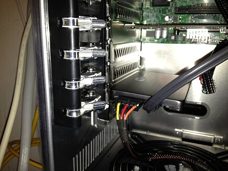

Sure thing... it wasn't anything fancy to be honest... actually its quite crude and I'm not sure how you would do it with another case due to one of the unique features of this case.
The A77 case comes with a Power Supply strap that mounts on the powersupply without the use of screws. Removing the hard drive cages in the A77F I ended up with 3x 4 harddrive cages. I just attached one the hard drive cages with the strap with a layer of foam to dampen it.
The strap I'm referring too
Wiring could be cleaner but alwell
Clearer picture of the attached cage. As pictured the Cache and the Parity drive in there with room for 1 more as its' a 4x3 cage
Thanks for the detail kevinsyn.  Very inventive solution!  I like the idea, the only problem I would have is that my power supply (TX-850 V2) has an intake fan on top and I would be afraid to mount the HDD cage (or foam) atop that intake fan.  I wonder how much clearance the PSU intake fan needs for airflow.

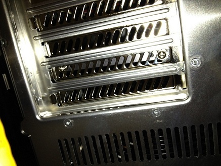

Since the PC-A77F case has so many PCI brackets, I'm going to see if there is a internal case HDD bracket that might use 1-2 spare PCI brackets but allow suitable airflow for the power supply.  This might work since the motherboard (X9SCM-F) is a microATX.

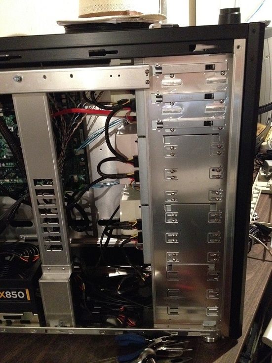

I used a big pair of needle nose pliers to start a very slight downward bend on the tab and then used a multiple passes with a 6" c-clamp to flatten each tab.  I torqued down the c-clamp to get all the tabs essentially flat. The flattening process with the 6" c-clamp did leave a slight imprint of the clamp ends in the case but that's OK.  Took a while to do this and was a bit of a pain but the good news is its a "one-time" step.  If I remember correctly there were a few tabs towards the back of case where I had to get a bit creative with the c-clamp placement but it's definitely doable.
I also removed all of the horizontal aluminum dividers before installing each Supermicro CSE-M35T-1B 5-in-3 drive cage.  This gives more room to work with to install each cage.  (I had problems inserting the cages (too tight) until I removed the horizontal dividers.)  You can remove the screws holding each horizontal aluminum divider with a small screw driver.  The top horizontal divider was a bit trickier (for me) since the access holes were slightly misaligned with the screws, but if you have an assortment of small flathead and phillips screwdrivers you can get all the screws out and then remove all the horizontal aluminum dividers.
Adding the Supermicro CSE-M35T-1B 5-in-3 drive cages in the PC-A77FB case reinforces the vertical structures without the horizontal aluminum dividers, so your case will be solid even without the horizontal dividers.
I didn't have any trouble installing (3) Supermicro CSE-M35T-1B 5-in-3 drive cages.  I still have a 4th drive cage to install from my other unRAID server.  I'll install the 4th drive cage in the bottom slot once version 5.0 final is released and I port everything over from my existing 4.7 pro server to the new server (2nd unRAID server in the Lian Li PC-A77FB case).

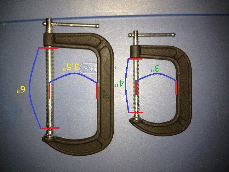

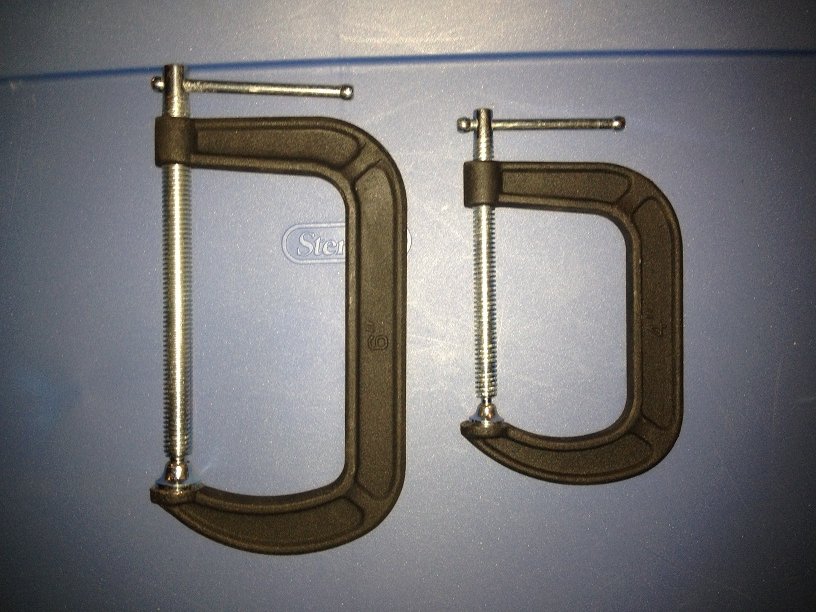

If you flatten the ~ 9 tabs in the top section with a c-clamp (see attached picture) and remove the horizontal dividers between each section, you won't have any trouble inserting the Supermicro CSE-M35T-1B 5-in-3 drive cages, no forcing required.
I had both 4" and 6" c-clamps.  I think I used only the 6" clamp since the clamping surface area was greater (compared to the 4" clamp).  I would think these c-clamps would be readily available in Holland at a hardware store.  They cost ~ $10 here in the USA.
This 4" and 6" does that refer to the width or depth of the clamp? Do you need a certain depth or can you use a standard c-clamp.
See the dimensions in this picture.  As far as I know they are regular c-clamps.  I believe I only used the 6" c-clamp.
