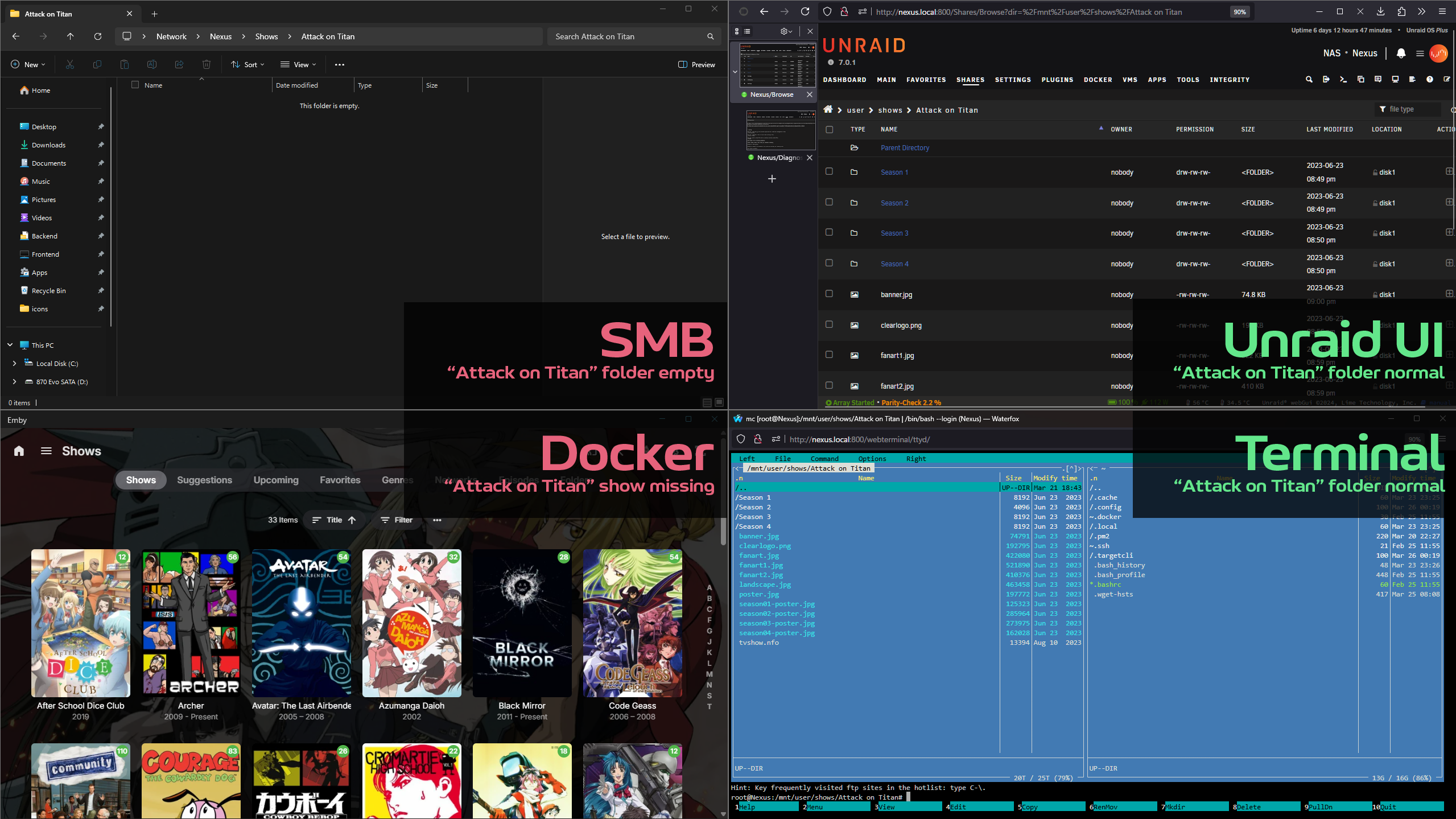

Hi all, my mover was getting stuck with a folder in /mnt/user/storage with Japanese characters. I didn't end up needing that folder, so I deleted its contents entirely using Midnight Commander in the terminal. That was less than a week ago.
At some point over the last few days, I've noticed I'm missing data in /mnt/user/shows. In fact, out of my small 90-ish show library, I only have 33 shows left, many with missing seasons.
When accessing the Shows share via SMB:
  • For a show that's still there (a.k.a. still showing in Emby with at least 1 season) - opening its subfolder reveals all normal contents. Any missing seasons' folders are still there, just empty.
  • For a show that's no longer in Emby - its subfolder is still there, just empty.
When accessing the Shows share via the Unraid UI however... all the data is still there, and I can even view images/etc via the Unraid UI. It's just Docker apps & SMB that can't find it. I've attached a screenshot explaining the situation (along with my diagnostics of course).
I'm running a parity check now (I made sure to un-check "Write corrections to parity" beforehand) and I guess I'm just at a loss for what the situation is exactly. How do I know if I'm missing data elsewhere? How could this have come up? Is it maybe some sort of XFS corruption? I know some about Unraid and have been using it for a few years now, but not enough to handle a situation like this, so any help would be hugely appreciated. Thanks a bunch in advance.

I went perusing my Emby logs and found this (Smiling Friends is also affected in the same way as Attack on Titan). Could this whole situation stem from a permissions issue? How would I check for that? Is it safe to run something like the Docker Safe Permissions Fix if there's a chance my data is corrupted?
2025-03-23 03:29:05.432 Error App: Error in GetFileSystemEntries for /mnt/shows/Smiling Friends *** Error Report *** Version: 4.8.11.0 Command line: /system/EmbyServer.dll -programdata /config -ffdetect /bin/ffdetect -ffmpeg /bin/ffmpeg -ffprobe /bin/ffprobe -restartexitcode 3 Operating system: Linux version 6.6.78-Unraid (root@Develop-70) (gcc (GCC) 14.2.0, GNU ld version 2.43.1-slack151) #2 SMP PREEMPT_DYNAMIC Thu Feb 20 13:33:15 PST 2025 Framework: .NET 6.0.36 OS/Process: x64/x64 Runtime: system/System.Private.CoreLib.dll Processor count: 12 Data path: /config Application path: /system System.UnauthorizedAccessException: System.UnauthorizedAccessException: Access to the path '/mnt/shows/Smiling Friends/Season 1' is denied. ---> System.IO.IOException: Permission denied --- End of inner exception stack trace ---

The terminal shows everything's there, even the "! HEVC status.txt" file I made at some point. Though, good catch - the permissions on everything are set to "nobody".
I guess my questions are:
  • Would this be a job for the Docker Safe New Perms tool?
  • If so, do we know how this happened?
  • What are the chances this is a sign of corrupted data?
Thank you!
