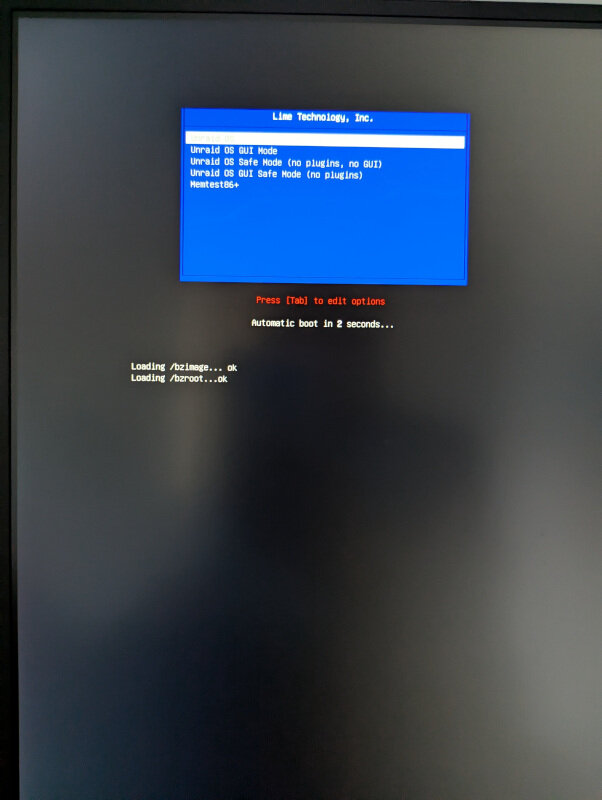

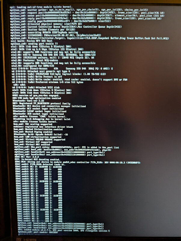

Does anyone have any idea why when I boot with the:
3080 (first image) I get the text output of the boot process and can interact with the command line after boot (this is expected)
5080 (second image) is installed I see the text for only the first few lines of boot and it stays that way on the screen boot a vm using that GPU (will be black screen)?
I can't help but think that the two issues are related. How can I get Unraid to actually display the text when booting? Do I have to install the GPU drivers on Unraid (never had to do this on any other card)?
