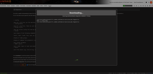

(Before anyone asks, I am unable to run Diagnostics to attach...see image below)

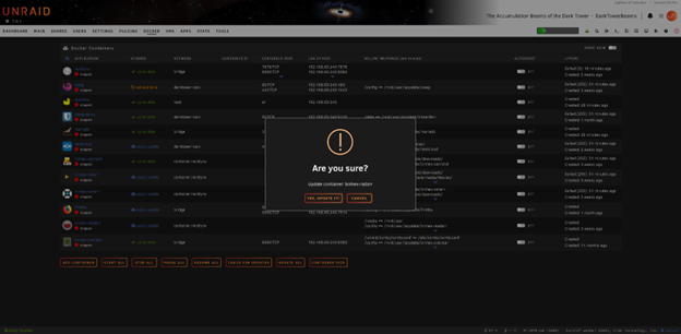

In an effort to make this short, I just saw an OOM error (32Gb, and never a problem in the past), ---OS loads fine but then just doesn't respond (just stalls/locks up), ----tried to update some of the Dockers...button "Yes, Update It" changes color but does absolutely nothing (I have to type in the address bar which page I want to switch to).

I was able to pull diagnostics; attached.

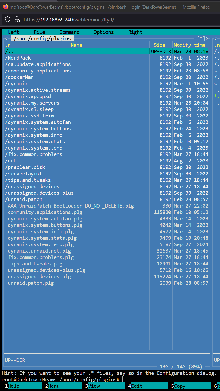

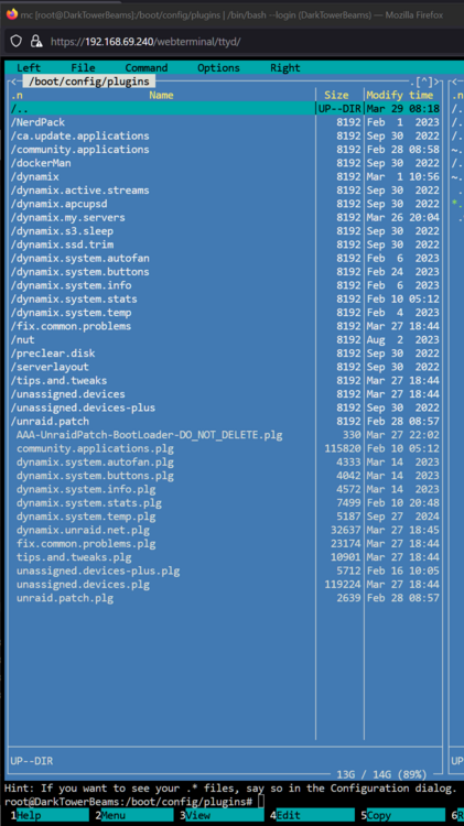

As mentioned if the system starts in Safe Mode and not in Normal mode then a plugin is probably the culprit.   Providing a list of the .plg files in the 'config/plugins' folder on the flash drive might allow us to give an indication of which plugin is likely to be the issue.

As requested, please see the attached list of .plg files. (apologies for MC view. My SMB seems to only work when it wants too, so I couldn't use Win File Explorer.)

None of those spring to mind as being an issue I am afraid.  Be interested if anyone spots something in your diagnostics or has a suggestion of something to check for.
I would delete the NerdPack folder as that looks like a remnant of the old ‘nerdPack plugin that is no longer supported.  It should no longer being used.
Also check if you have anything in the ‘extras’ folder on the flash drive as that might be a source of your issue.
