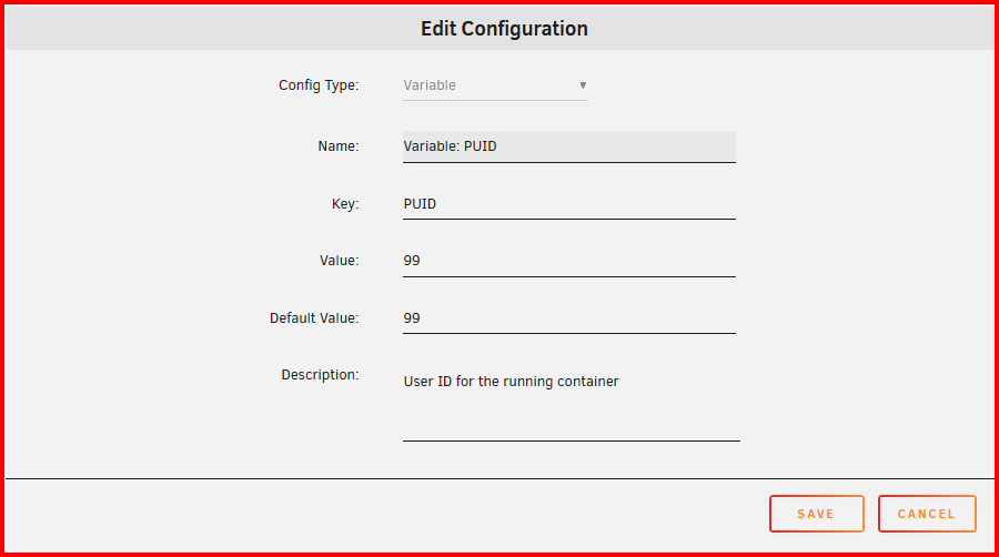

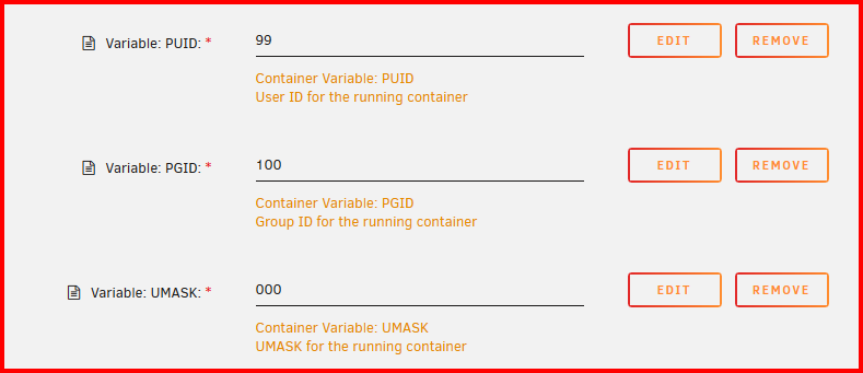

For a Docker container, this is the recommended setup of the Docker Container to allow full access to files created by the Docker:
(PUID 0f 99 = nobody    and     GUID of 100 = users    )
Here is what the Edit function looks like:
This should also set up things for NFS to work correctly also.
