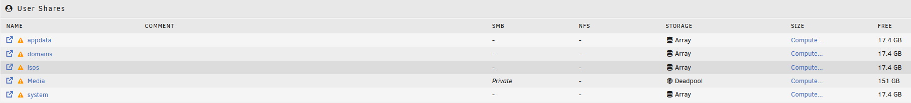

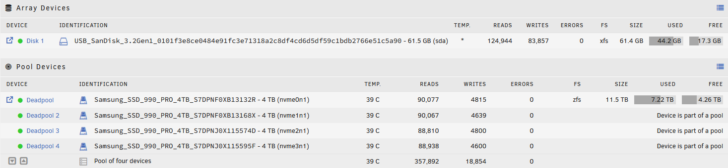

The network drive is suddenly displaying incorrect storage space.
Yesterday, it showed 7.22TB used out of 11TB, but today it’s showing 140GB used out of 391GB.
I’ve tried disconnecting and reconnecting the drive, recreating the pool, restarting the array, and running a check—nothing changed.
Despite this, all files remain accessible without any issues.
Any idea what might be causing this?

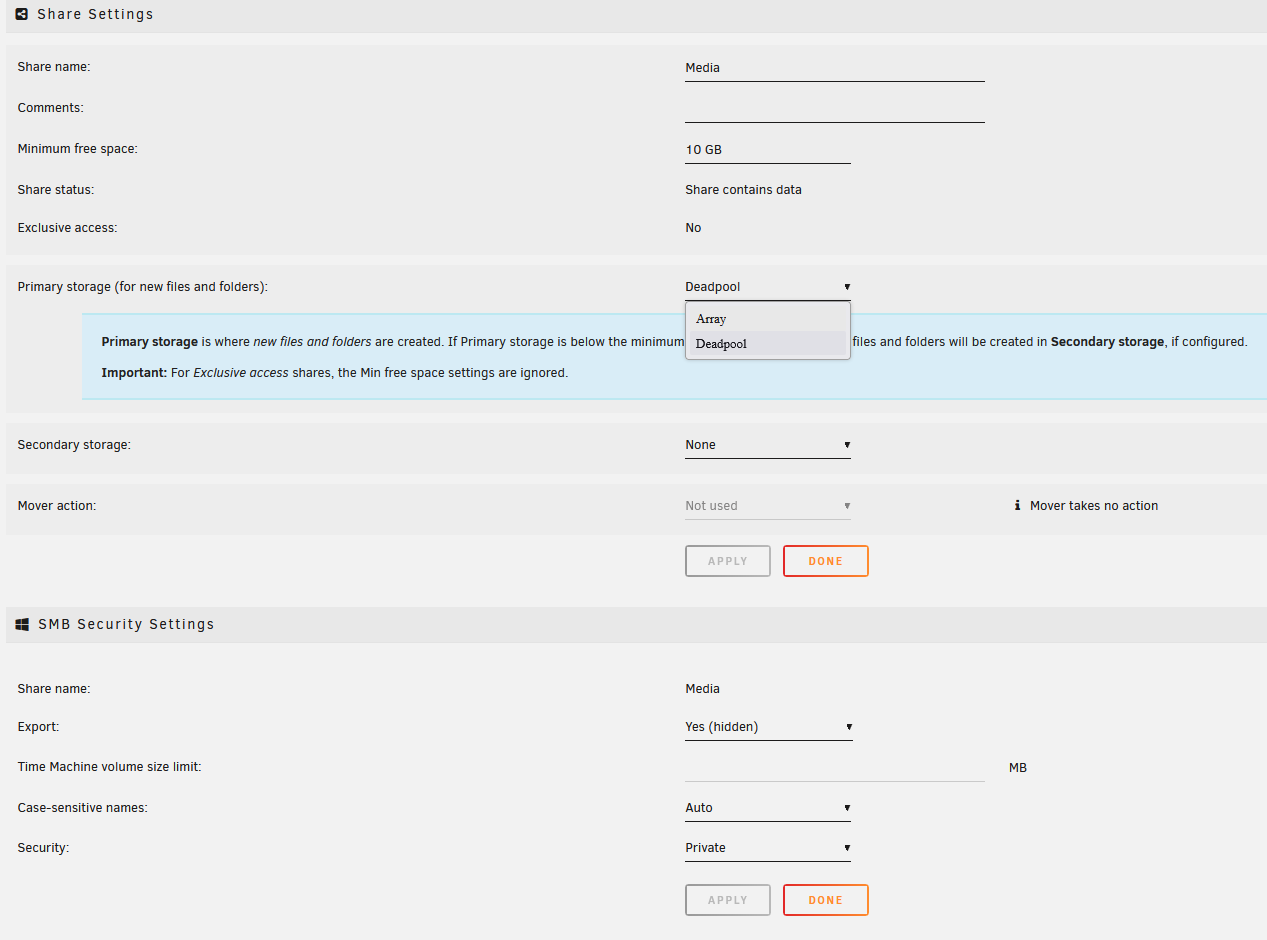

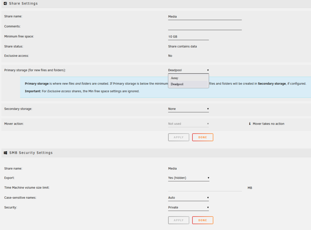

The Media share reports 151GB of free space. Below is the share configuration for the "Deadpool" pool.

Looks normal, the only thing that is not correct, is that the media share also exists on the flash drive, but I don't think that would cause that issue, still, delete /mnt/disk1/media, assuming there's nothing important there, and retest.

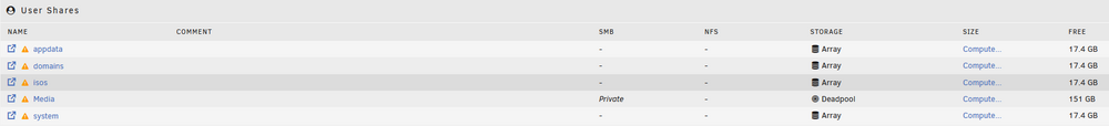

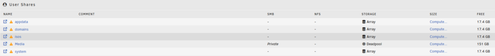

Looking at the screenshot, Unraid is showing /Media with 151GB free (when I should have like 3tb), so it's pretty strange.
Yeah, and since the share also exists on the flash drive it would be included, still not clear where that value comes from, but it may not be an issue with v7
I updated to v7.0.1, but I couldn’t figure out how to start the pool without the array.
That said, after the upgrade, the disk sizes are now displaying correctly - so everything’s sorted!
Thanks!
You have to set the number of slots for the array to none.
