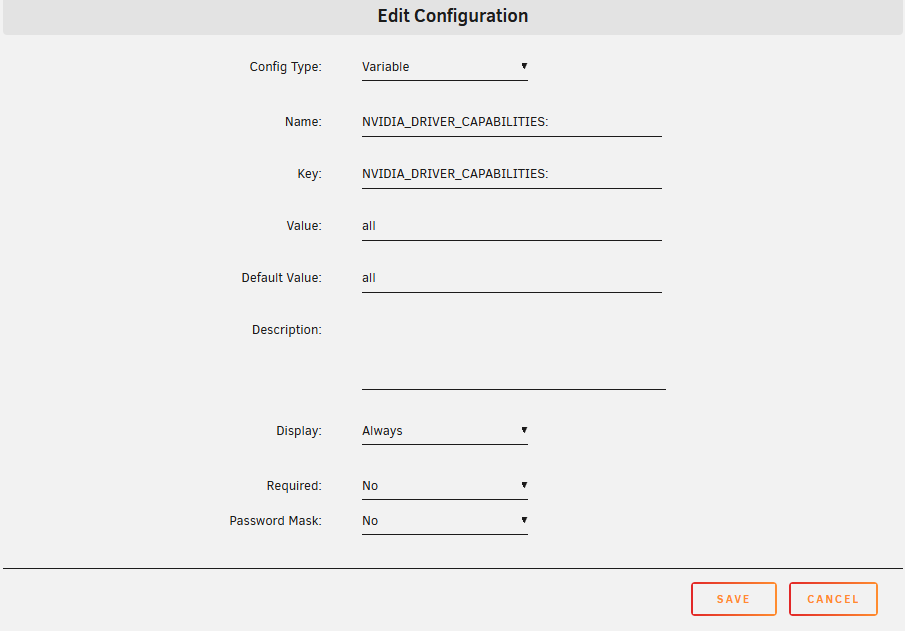

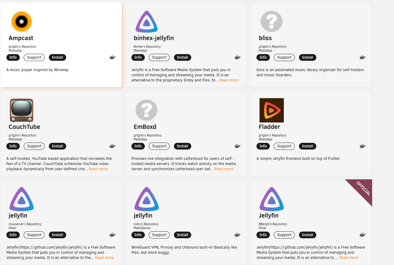

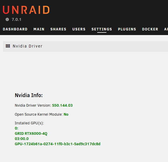

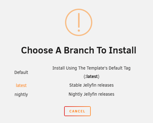

March 29, 20251 yr Community Expert "--device=/dev/dri" helps but is not the way... this is more for intel cards. Some nvidia need the extra access to check. per ICH777 its actual using /dev/nvidia you would need to check it and that is orginaly part of the puzzle... You will need to make sure the g card is not VFIO bound, it must be accessible to the host... You will need to install the NVIDIA plugin driver. web UI > Settings > nvidia You will see your quadro card under NVIDIA info and can run nivida-smi in teh terminal to see the card... Next to use a nvida GPU with unraid the min requirement after the host plugin and driver are working is: Docker settings: in the extra parameter filed you need to add --runtime=nvidia in the docker tempate you may need to add variable: Depending on your Jellyfin docker, as the docker needa to have the drivers in the image... You may need to read the overview or additional requirement to add the GPU... I recommend using linuxIO - linux server jellyfin template and image Latest tag then adding the NVIDIA runtime and additional docker variable... Edited March 29, 20251 yr by bmartino1 typo
