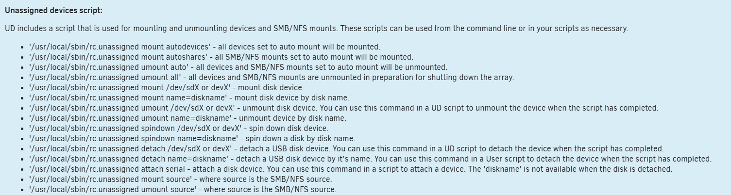

If you click on the help icon while on the Unassigned Devices tab you will get all possible commands. Let UD mount/unmount. It knows exactly how to mount/unmount on Unraid:
E.g.: I use these commands from within User Scripts to mount/unmount an external SMB resource:
#!/bin/bash
#backgroundOnly=true
#clearLog=true
/usr/local/sbin/rc.unassigned mount //192.168.178.101/disk1
/usr/local/sbin/rc.unassigned umount //192.168.178.101/disk1
Thanks  this is a big help, didn't know that list was there.
I see you did it by IP address, but my SMB share is mounted by name.
Which of these is correct?  They are in order of what I think is most likely correct, but just checking.
/usr/local/sbin/rc.unassigned mount //UNRAID_BU/BACKUP
or
/usr/local/sbin/rc.unassigned mount /mnt/remotes/UNRAID_BU_BACKUP
or
/usr/local/sbin/rc.unassigned mount //192.168.XX.XX/backup   (I don't have anything mounted by IP on UNRAID, just the NAS Name.  The IP is how I would find it on a windows machine)
According to the help text for SMB/NFS, you mount the source name it has within UD. So in that case its  //UNRAID_BU/BACKUP.
Edited by hawihoney
thanks for the help with this.    working fine now.
