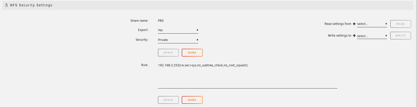

I was looking for the no_root_squash option for the NFS exports but could not find it in the GUI.
Before I copy over the /etc/exports file after each reboot, is there any other way to specify it for the NFS exports?
Thanks a lot!
Solved by bmartino1
It is better to use the UNRAID SHARE OPTIONS!
example:
192.168.2.253(rw,sec=sys,no_subtree_check,no_root_squash)
so only 2.253 can nfs connect to PBS
However, the limitation is i only want to share the images folder within PBS... You would need to add the share info to exports...

Under the Main Share of the folder you are using in share make the nfs share private.
and use rule:
192.168.1.x(rw,sec=sys,no_subtree_check)
Per your requiem net of removing the no root squash option.... so set the ip of the one machine that is rsyncing file too...

SO, working with Unraid and NFS you would want to configure an NFS share to be:
-Private
-Accessible by root from another Linux machine
-With no_root_squash so rsync can preserve ownership using chown
-Set only through the Unraid web UI
this sounds like a mis-understanding on how the remote machine and how to connect to the share...
as this private rule should work with Rsync...
