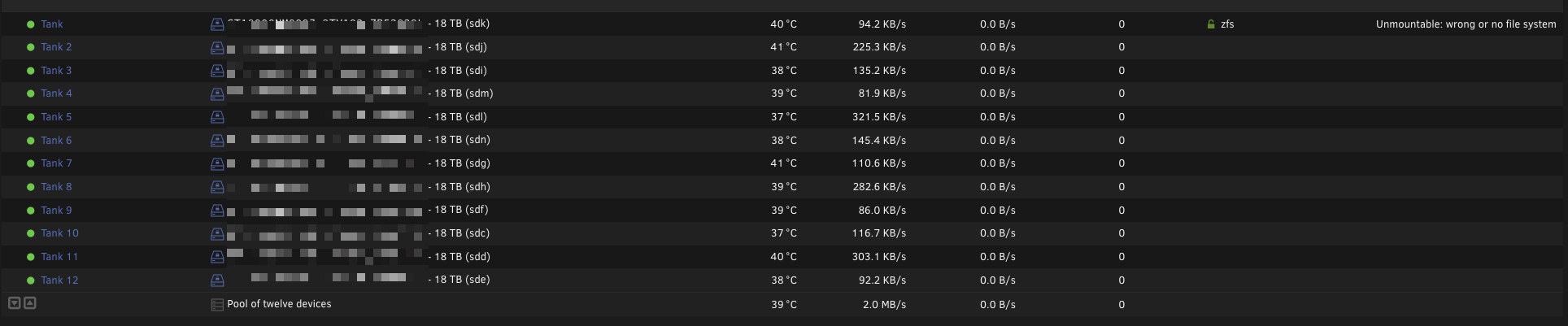

Here's a quick screenshot of that pool:

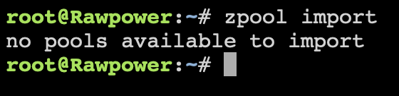

With the array started, post the output from
zpool import
Here you go:
However it is imported already so the output does make sense. If I stop and start the array, everything works as expected. I have to restart the whole server in order to run into the issue again.

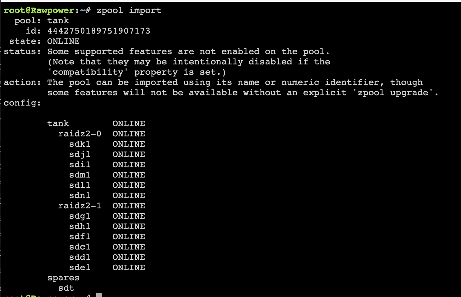

Here's the output after restarting the server, starting the array while obtaining the "Unmountable: wrong or no file system" on the tank pool:
I remember doing one of these Zpool upgrade commands back when I had just switched to Unraid 7.0, surprised to see this again. Would it be the explanation behind all of this?
Thanks
Edited by Maxime Lacelle
Pool has a spare, that's currently not supported, you need to remove it and reimport the pool without it, can post detailed commands if needed.
