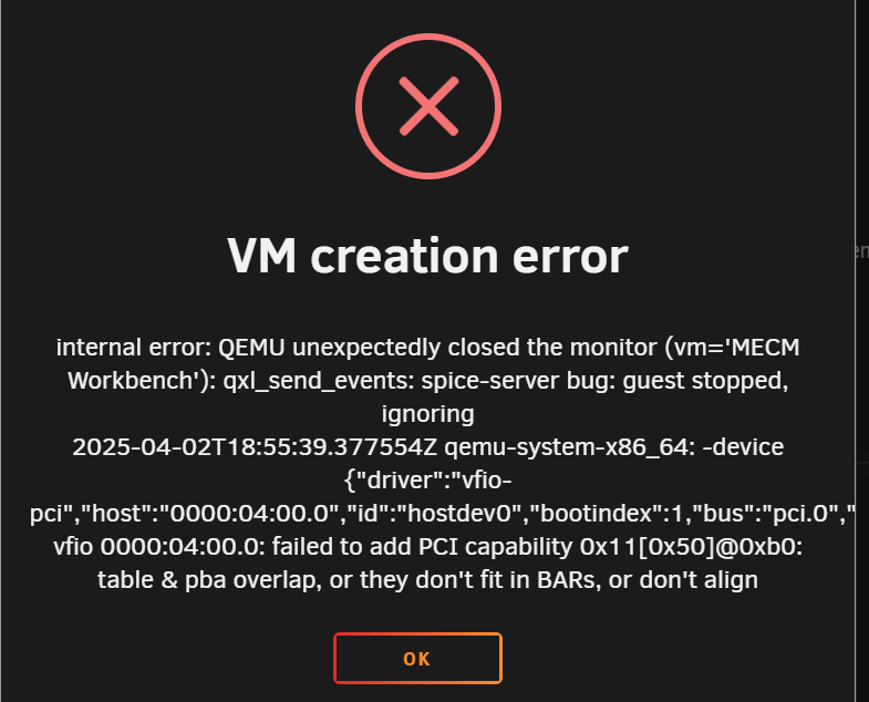

So I rewatched the video of SpaceInvadersOne:
I've made following:
Selected my NVME disk and binded it to VFIO :
- Select the Nvme disk - at the bottom click on : bind selected to VFIO at Boot , then rebooted the server. - Created a new VM, where I selected the Nvme as a PCI device
- Created a new VM , Nvme showed up as PCIE.
- When I try to fire up the VM, following error appears:

I've tried to bind it as VFIO (see my updated post), but I got an error.
I will try to unbind it from VFIO, reboot the server and try through /dev/disk

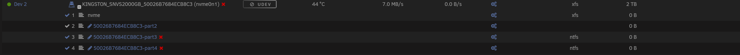

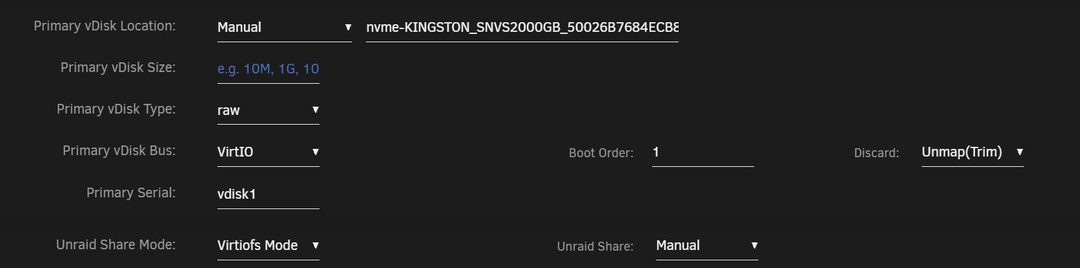

So... I've unmounted the Nvme from Unassigned Drives.
Now I see:

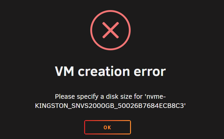

Nonetheless, when i try to add it to the VM, it doesn't work since it want a size.
I still not get why VFIO didn't work since:
But let VFIO apart for a moment.
How exactly to do it with the ID?

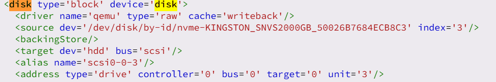

I've tried following:
But...
I've now tried following:
So putted the nvme0n1 (which is my NVME) directly as a /dev/ inside the config of the VM...
VM fired up, and the ISO of windows was able to see the whole disk.
I don't know If this is the correct way.
I think I have to set something more to get the NVME working correctly tough...

You need to include the full path /dev/disk/by-id/.......
Using /dev/nvmen1 should be fine but that could change if hardware is changed.

I've tried with the full path but somehow it won't start :-(
But with /dev/nvme0n1 it's working.

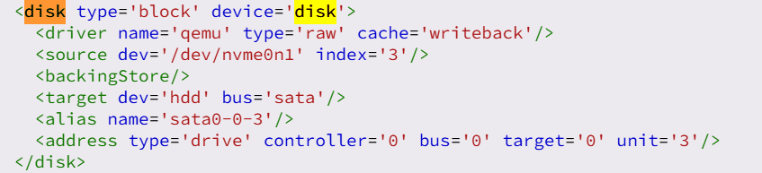

Performance arent so great in the end unfortunately ...do I have to change the <target dev='hdd' bus='sata' /> to bus=scsi or something?
My bad, was a misstip, now with:
Is working.
But still confused if it the bus has to be SCSI or SATA for a PCI NVME..
EDIT:
if bus = scsi, disk is not detected by Windows installer
if bus = sata, disk is detected
It should be correct with the bus = sata right?
Is working.
EDIT:
Sata should be fine.  It is using a device path on the host so will show as a disk not a pci device.

Still a little bit odd that it wasn't working as a VFIO though, since it's usable mapping the device path directly, do you think I made something wrong with the VFIO mapping? Or maybe I'm missing something there?
The NVME is on it's own group:
Mapped, I was able to install Windows SVR2025 on this disk (I've cleared it first).
What's a little bit odd is that, when I stopped the VM it's shown as follow in the UD :
Two partitions are shown as XFS - which is a little bit unclear to me.

I saw a threat with issue with passthrough, it seems related to the SM2263XT, and there is a possible workaround, but I dont quite know how to edit the xml in the correct way - and it seems not to be "so stable".
So I will try to use the "normal mapping", without VFIO with this drive for the moment, and eventually use another NVME drive.

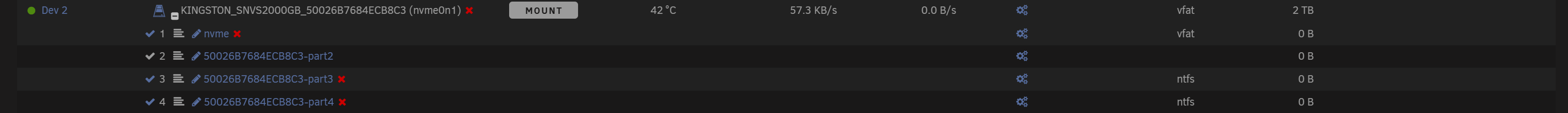

Still wondering on the partitioning FILESYSTEM of the NVME when windows was installed.
EDIT2:
After redoing the whole thing with Mapped drive at the end it seems to show the right FS:

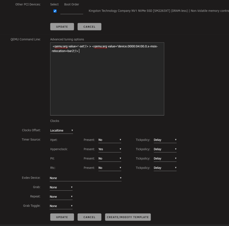

Hello,
I've tried what you suggested:
I then clicked "update", but it seems not to work.
Then I wrote it like this:

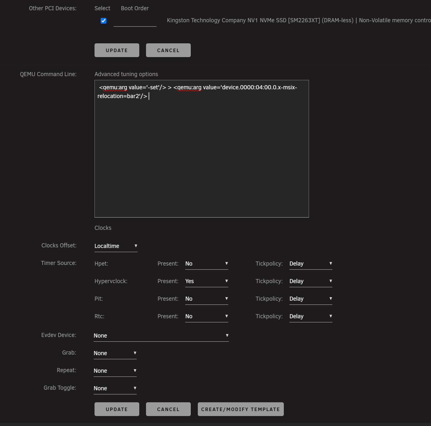

Looks like you cannot use the PCI ID but need to have an alias. This is unlikely to be removed if you change via the GUI.
Change qemu part to be.
<qemu:commandline>
    <qemu:arg value='-set'/>
    <qemu:arg value='device.nvmetest0.x-msix-relocation=bar2'/>
</qemu:commandline>
Save then edit and change to XML mode and add the alias to you nvme line.
  <alias name='nvmetest0'/>
</hostdev>
Thanks SimonF;
So I've found in the end where the <hostdev mode='subsystem' type='pci' managed='yes'> is (near the end of the XML), I've tried to add the:
<alias name='nvmetest0'/> , (line 129) so my .XML is like that:

  <qemu:commandline>
  </qemu:commandline>
</domain>
But when I save it, it's reverted without the <alias name='nvmetest0' />

Thanks SimonF;
Did you save in xml page or did you revert to form view. Need to save in xml view.
Saved from the xml view, but still get's overwritten.
I've tried to do something like described here:
Which states that you have to call the alias like ua-xxxx
So I removed the qemu commandline (removed it), and added directly following in the .xml
But it doesn't work - the Vm starts (sort of... it freeze the GUI for 1min or so.. and then you cannot connect to VNC... so probably something is still wrong - or wronger 😞 )
<domain type='kvm' xmlns:qemu='http://libvirt.org/schemas/domain/qemu/1.0'>
  <name>test</name>
  <uuid>c60d6936-9b00-8cdc-788e-e9afe3a7da34</uuid>

Update:
After waiting long enough the VM starts indeed (strange it need so much time though... like 1/2mins)
And I'm not able to start VM with VNC which prevents me to start the ISO - so either the performance are killed for a reason, or something is still missing.
