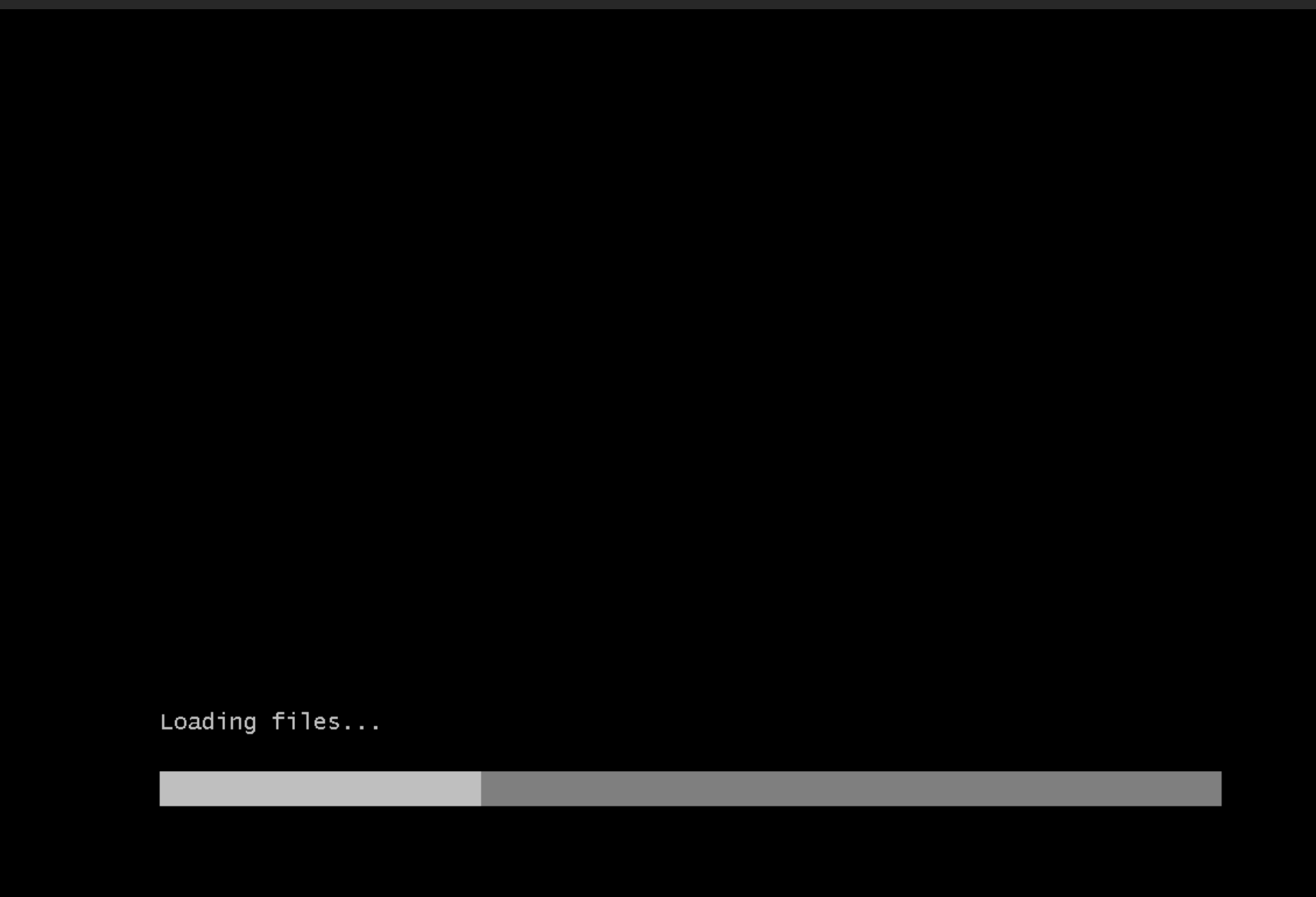

I've tried to remove the BOOT ORDER = 1 from the XML, and now I was able to start the ISO:
But after 5min is still on the "loading wheel" - instead of showing the "Windows Setup" which should appear after 5-10sec after Loading Files is finished.
i'll try now removing the driver string you mentioned.
Just tried, after the start of the VM (which took exactly the same time), I checked the .xml and
<driver name='vfio'/>
Was there again.
After a good while, the loading wheel disappeared, but instead of showing the "Windows Installation Setup" its only shows a black screen:
I'm really tempted to get another nvme drive (samsung) - but I'm not sure if I will not encounter the same issue... 😐
