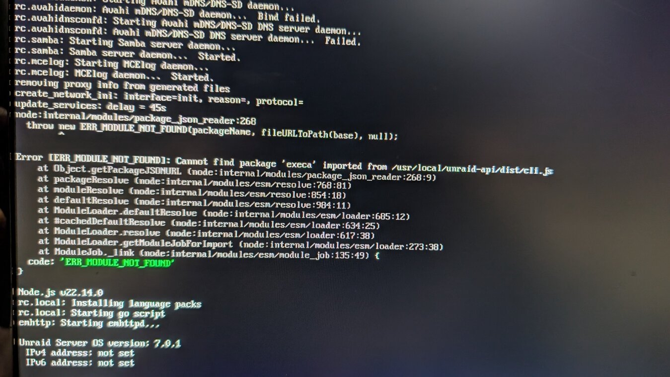

Updated to 7.0.1 and server now gets error when starting up (ERR_MODULE_NOT_FOUND)
Hello, I hope you can help, I just updated my server to 7.0.1 and now the system doesn't start up properly. I get the error "Error (ERR_MODULE_NOT_FOUND): Cannot find package 'execa' imported from /usr/local/unraid-api-/dist/cli.js
Anyone know how I can solve this? I do get a login in the CLI but no web page.

@trurl How do I get diagnostics out of the server when I can't reach it?
Click the Diagnostics link to find out
Looks like your static network assignments don't agree with your gateway.
Delete or rename config/network.cfg on your flash drive so it will use defaults.
Really better if you let your router reserve an IP by MAC address instead of assigning static IP on your server.
Thank you @trurl I had to remove the network.cfg file and I had to remove the reservation from my router and then the system started up with an IP, looks like something was jacked there that only came to light now.
