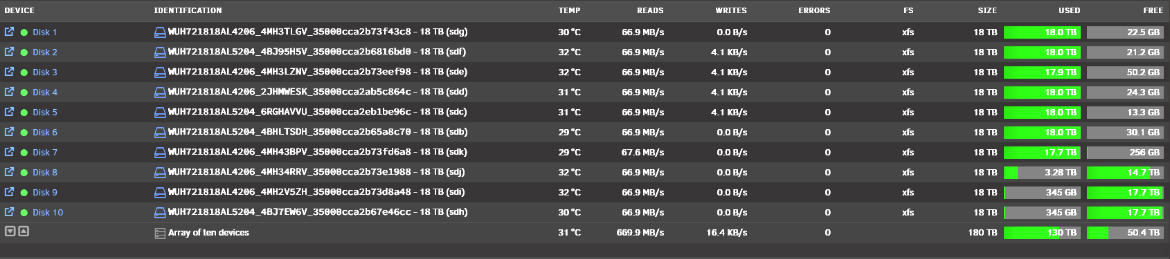

But I am now unable to sync the parity again. It’s starting correctly (at around 90MB/s) but at one point it will appear to continue but in fact stop completely and render the server unresponsive over time, blocking me to even stop the array or the docker containers if I wait too long.
I can generate the error by starting some dockers containers, but I am not sure it’s really related to them directly. A fix permissions does the same thing and I reinstalled all the containers just in case, but without improvement.
I think that it’s when some container starts to read some part of the array that the problem occur and that I have to reset the server by force.
By doing so, I have to fix the drives again (in maintenance mode) but I don’t lose any files anymore.

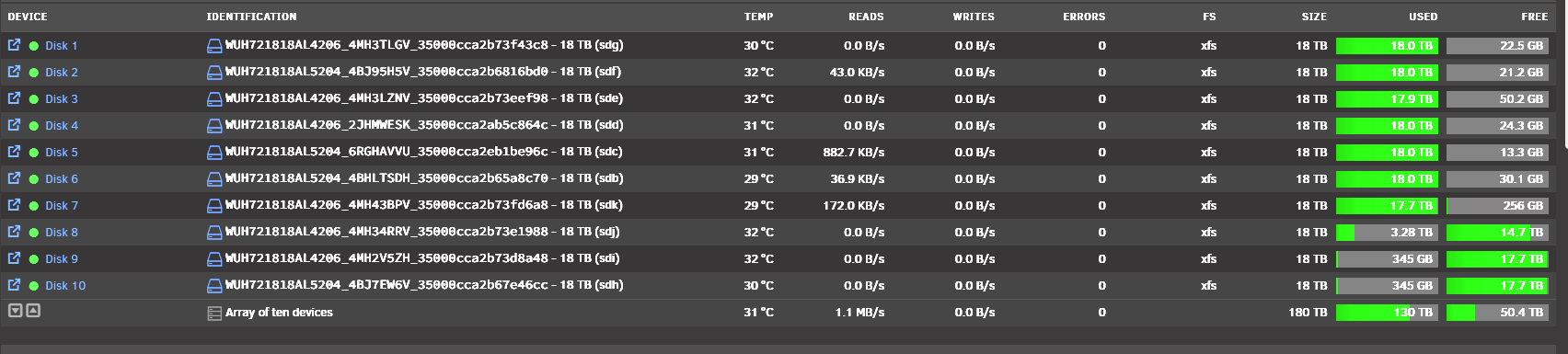

I even removed the parity drives and only did a read check of the disk of the array, but I have the same issue.
I also noticed several CPU errors in the syslog, but I was able to do a successful Memtest, so it does not seem to be related to the memory either.
Could you take a look at the diagnostic files and help me find the cause of the issue?
For the moment I think it could be a CPU problem or an error present on one of the drives, but an error that the disk check cannot find.
