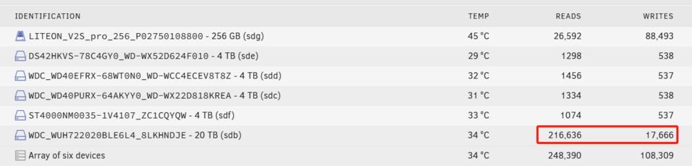

This 20TB hard drive is a Western Digital model, while the others are all 4TB drives. All 4TB drives can enter sleep mode normally. Previously, on version 6.12, this 20TB drive also could spin down. However, after upgrading to version 7.01, this 20TB drive can no longer enter sleep mode.‌
docker & VMS were turn off.
Installed "File Activity" but no programs are detected accessing it‌。
On the main interface, only this hard drive's read/write activity indicator is blinking.
strange is when ‌manually putting all HDD into sleep mode‌ causes only this 20T drive to wake up when a particular Docker container is activated, despite no explicit association between the container and the drive‌r. Other disks remain in sleep state during this process‌.

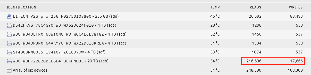

This time I confirmed that disk6 was excluded from the storage pool‌, and both Docker services and virtual machine functionalities were disabled‌(Disabled the Docker and virtual machine features in the settings menu.).  disk6 can spinning down,but i setting docker functionalities enable. disk6 turn on immediate.
Strange, I've already excluded DISK6 from the storage pool, and there are no files or Docker-related content on DISK6. The read/write values are gradually increasing

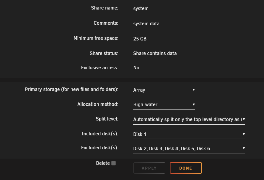

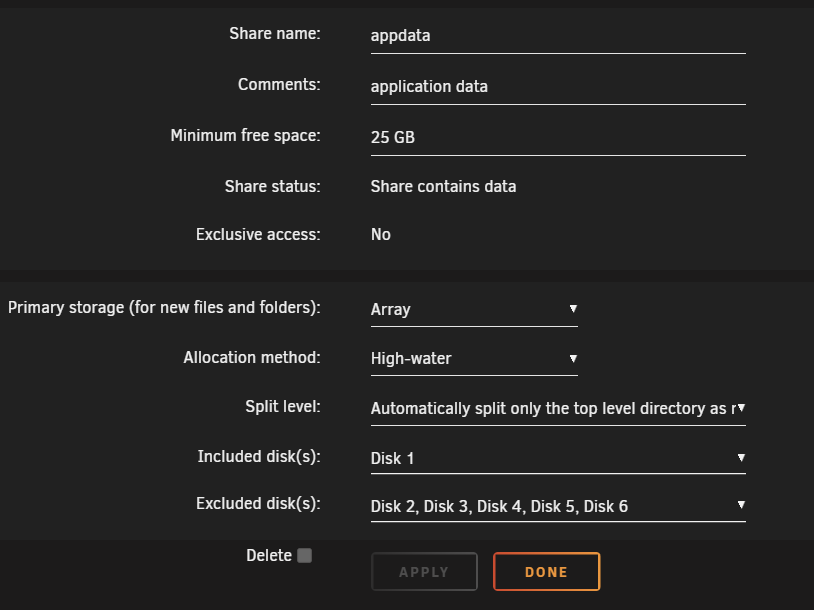

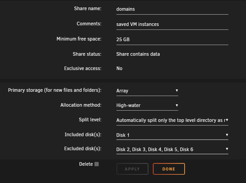

this is my share setting,appdata;domains,system,excluded DISK6,
f4aa43b0633bb529eb3b02fae5effa7.png.61c98f7d0ee124eb4302bb91a327d16a.png0ff3edfc594af162f2de5a55a053edd.png.425d8437d0cef327918b99955b1b85c3.pnga9e1d654bb98725554313f127881f4d.png.47cc48020484eabf0c9aeae4e2a5e1ce.png
That won't help now, since the disk already has files, you would need to move then first.
Also, there is never any good reason to set BOTH Include and Exclude.
Include already excludes all disks not listed for inclusion.
Exclude already includes all disks not listed for exclusion.
Use one or the other.
