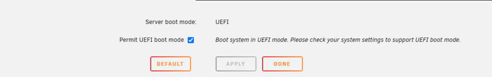

The issue your fighting in the backup comes down to how you originally were running unraid example as noted here:
and how syslinux is called to boot unraid bzroot
This tells me that your syslinx in the backup is not set correctly and that you are not booting in UEFI mode...
as explained in the docs and how to fix...
https://docs.unraid.net/legacy/FAQ/usb-flash-drive-preparation/#if-the-flash-will-not-boot-read-over-the-following-tips
by default unraid doesn't enable the UEFI boot...
When making trail flash drive I often have to use windows to run the make boot script but pre-format the flash drive and copy the files out of the zip in a ubuntu linux. I could never personal get the unraid creator tool to work correctly...
UEFI boot can conflict with secure boot due to keys and key changes. In bios via a boot override, you should see the unraid usb device...
You may need to also turn off fast boot and enable csm capability to boot into unraid as it is not using uefi...
Regardless, its clear that the flash drive is not setup correctly to be used as a bootable system for unraid either how you have the files on the drive or how syslinux on the drive is currently set...
