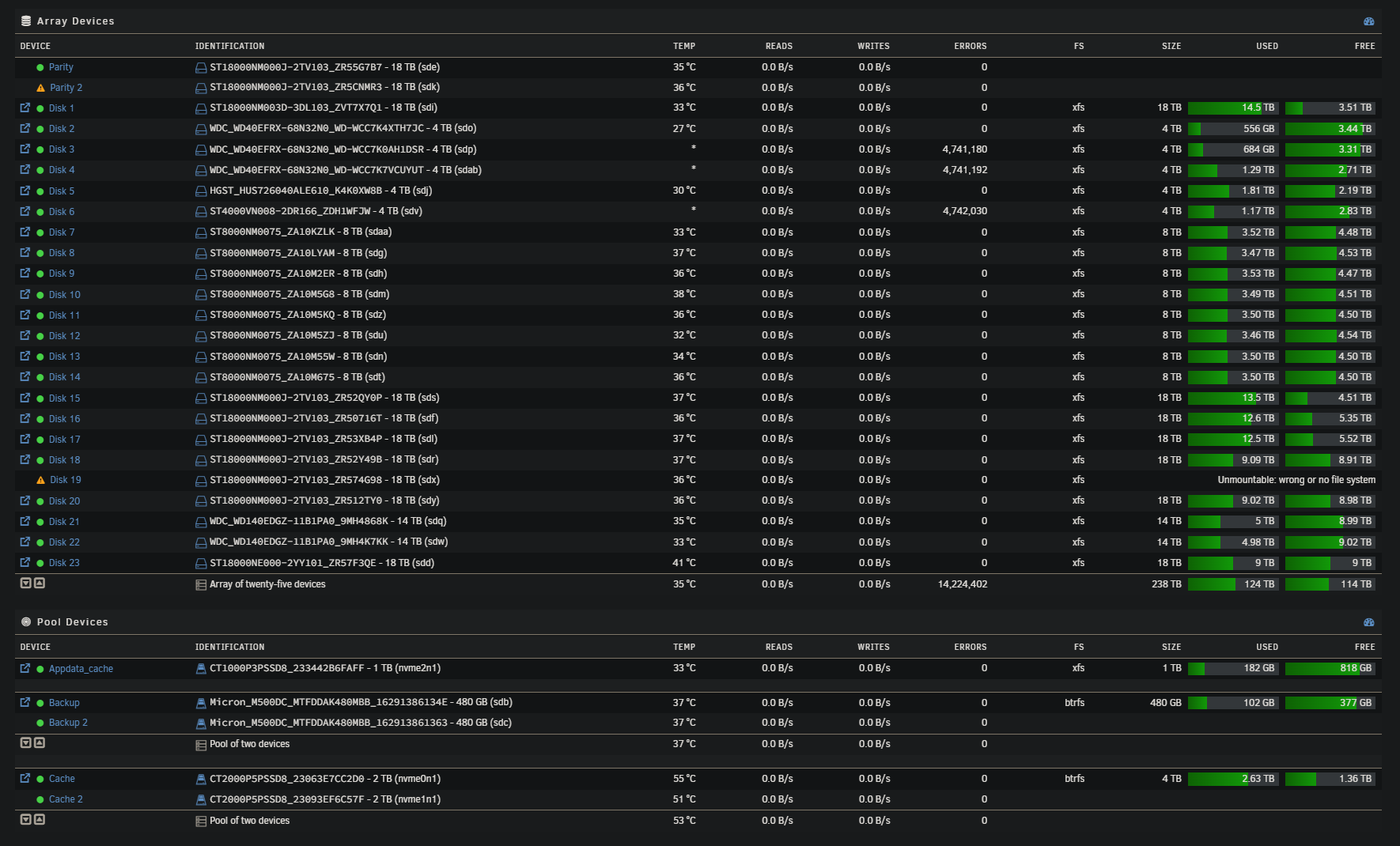

Rebuilding on a disk with "Unmountable: wrong or no file system" and 3 other disks millions of read errors during parity check

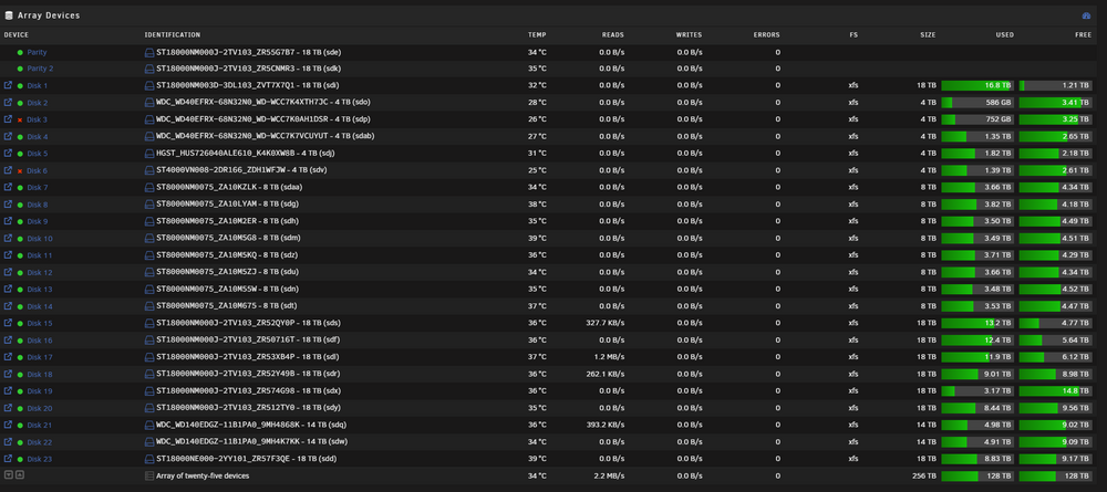

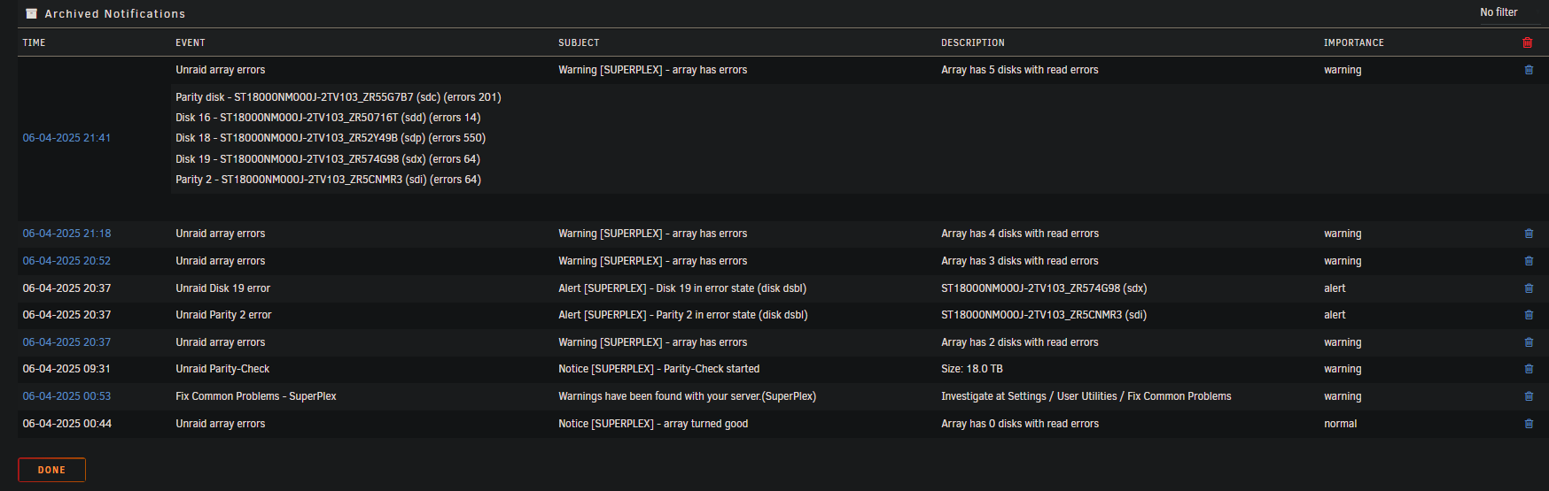

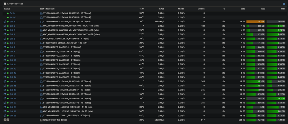

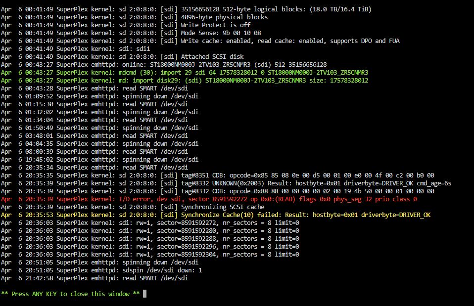

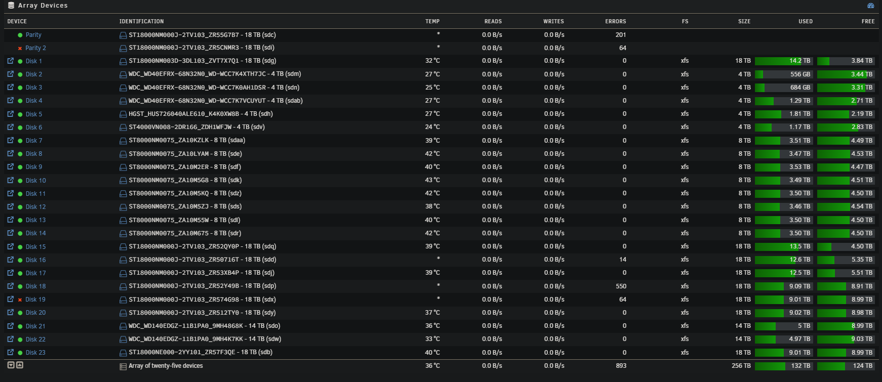

Not sure what is going on with my system, but I had a scheduled bi-quarterly parity check that kicked off a few days ago that disabled 2nd parity disk and my disk 19.

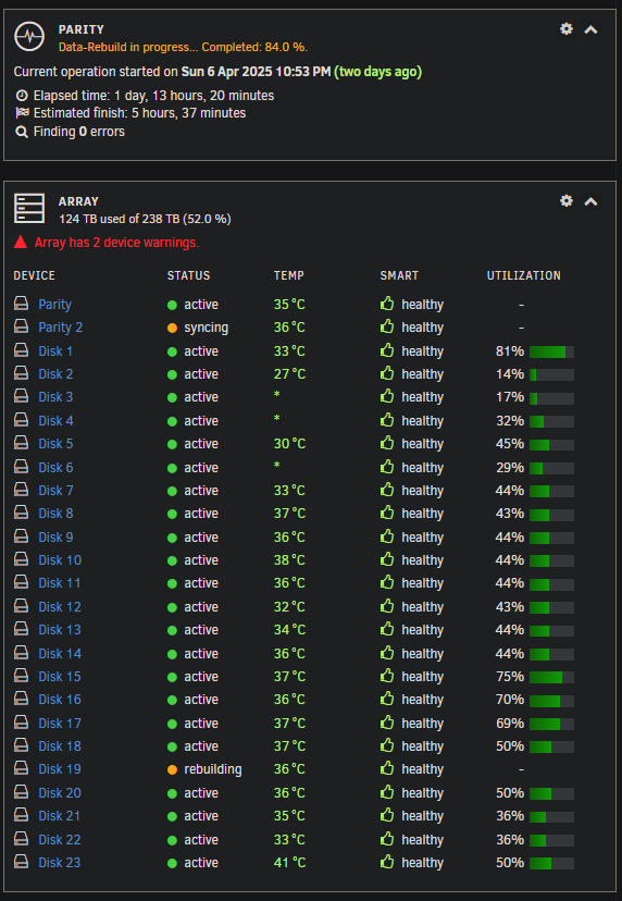

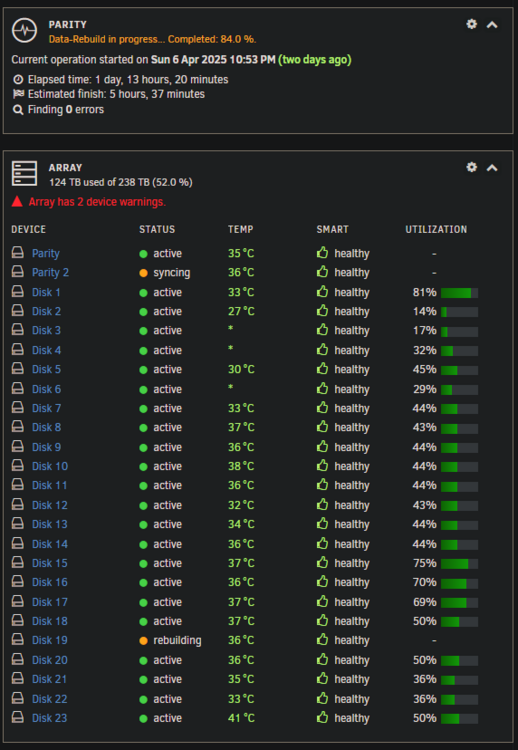

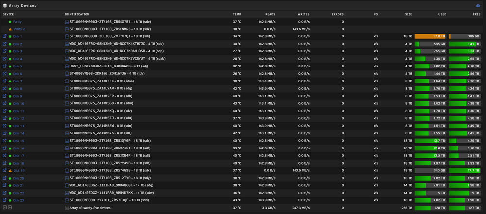

in an effort to resolve this I shutdown re-seated every cable and my HBA and most of my disks came back to normal and were no longer disable but the one disk 19. Parity sync / rebuild kicked off and currently while I type is at 84% complete with ~5hrs left to go. I'm really hoping this disk comes back to life with the almost 9tb of data that it has but if not, I'm okay with losing some data as none of it is precious to me and I believe I can get most of it back. I just want to have my server back into a healthy state, any help or direction is welcome. Additionally I have a new set of Mini SAS HD SFF-8643 to SFF-8087 cables showing up tomorrow to replace my current ones as a precautionary measure.
Below is my current state

You are rebuilding an unmountable filesystem on disk19. Usually we try to repair before rebuilding on top of the same disk, that gives more options for recovering data. I guess we will just have to hope for the best when we repair the rebuilt filesystem.
But...
problems continuing with accessing multiple disks, 3, 4, 6. It can't disable anymore since you already have two disabled. It must be able to accurately read every bit of all other disks to rebuild the disabled disks. Entirely possible (actually, probable) that disk19 can't be accurately emulated since some other disks can't be read.
Looks like all HDD are on the same controller. Either controller or power would be main suspects.
In fact, you should just stop it all now and try to fix those problems, maybe wait on your new cables.

Oh? Stop the parity sync/rebuild?
Rebuild can't be going well with all those other disks not being read. Disk19 rebuild is unmountable anyway, and parity rebuild is unlikely to be any better.
Does it change anything if those errors occurred after I passed the 4TB mark?
No, rebuild is rebuilding the entire parity2 and the entire disk19, but it doesn't have enough data coming from the other disks to expect that to be any good.
https://docs.unraid.net/unraid-os/overview/nas/#parity-protected-array
It might even be that if all the other problems were fixed, emulated disk19 would be mountable, since it could get the correct data for the emulation from reading all other disks. Then you could rebuild a mountable filesystem instead of the unmountable filesystem you are currently rebuilding.

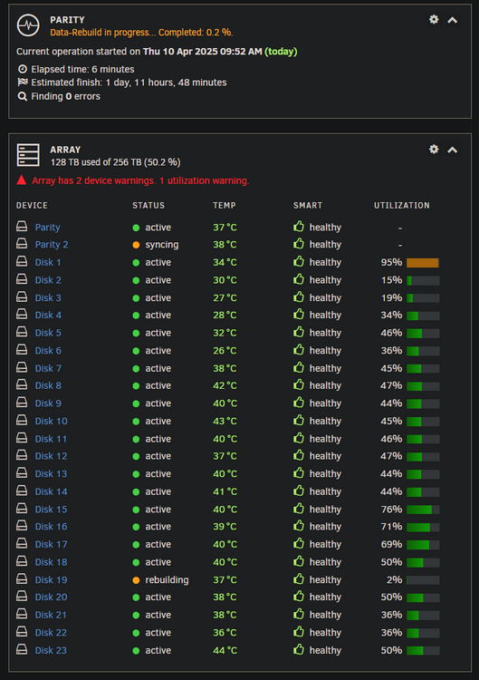

Cable has been swapped, drive 19 is still unmountable Parity 2 also still needs to be resynced, how should I proceed?
