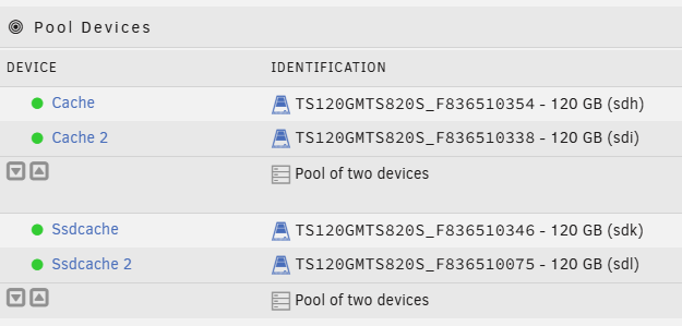

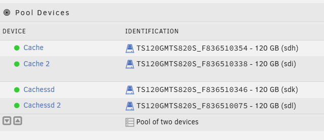

This is a bug, I can reproduce, it happens because the second pool starts with the same word as the first one, e.g., if you have a pool named cache, and then a second one named cachessd the same thing will happen
I will report the issue to LT, a quick fix would be to rename the second pool to just main, or mainunraid, for example, as log as it doesn't start with unraid.
Hmm But why it happens only to the first one? I have 4 pools named with unraid at the beginning?
Anyhow, good that you can reproduce it. :)
I will rename them then. ^^ Thx to take the time and find a solution or work arround.
