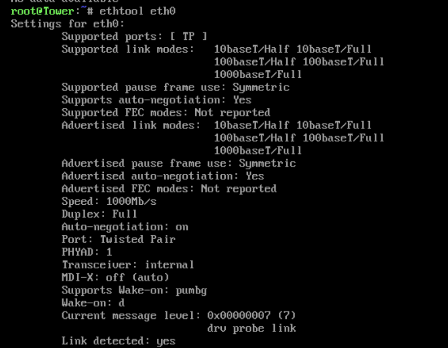

No, it's a Dell r720 with an NIC board with 4 ports (all are connected) and show up on ifconfig as connected at least:
