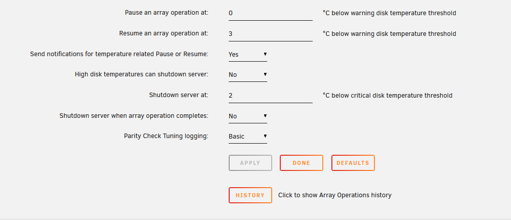

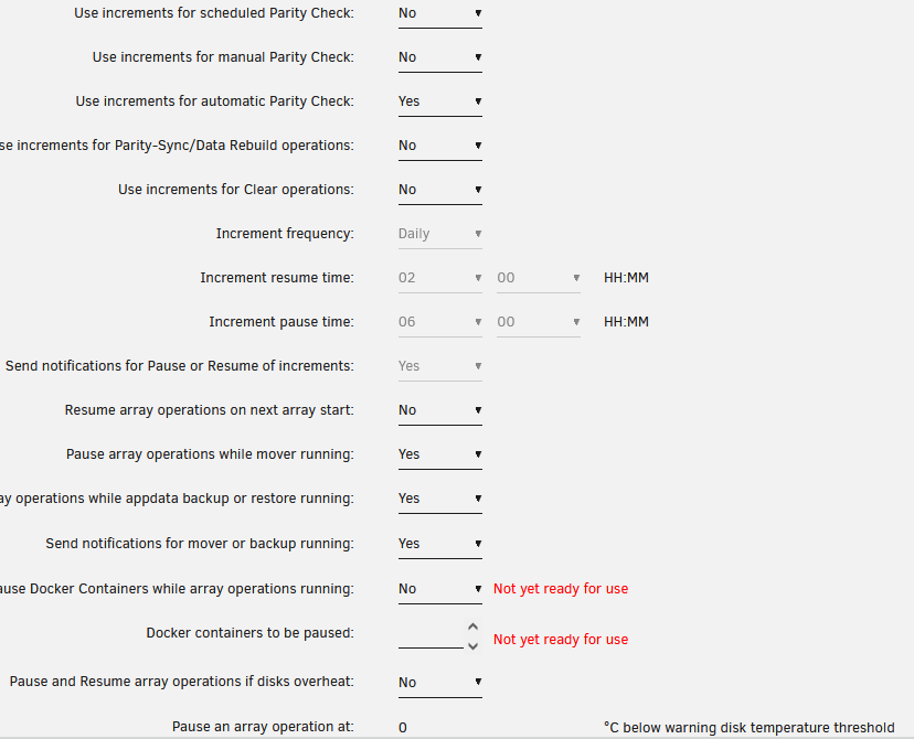

OK, wonder why it continued pausing after I changed the settings. Here are my settings if you can help guide to what will stop it from pausing. I didn;t notice any performance hit while parity check was running. I only use the server for Plex. None of my friends or family commented either. Maybe I got lucky

Looking at your logs you were getting pauses because Mover was running and you have the plugin settings set to pause while this is the case.   This is normally desirable as array operations and mover badly affect each others performance so you do not want them running in parallel.   You then get a resume when the plugin detects that Mover is no longer running.   On that basis the behaviour you were seeing was expected.
You do seem to have mover scheduled to run more frequently than the default of once a day in the middle of the night?
BTW:  Do you have notifications enabled at the system level?   I suspect not as otherwise you would have received them from the plug-in when it paused or resumed because of mover.
OK, then I will leave it be. Thanks!
