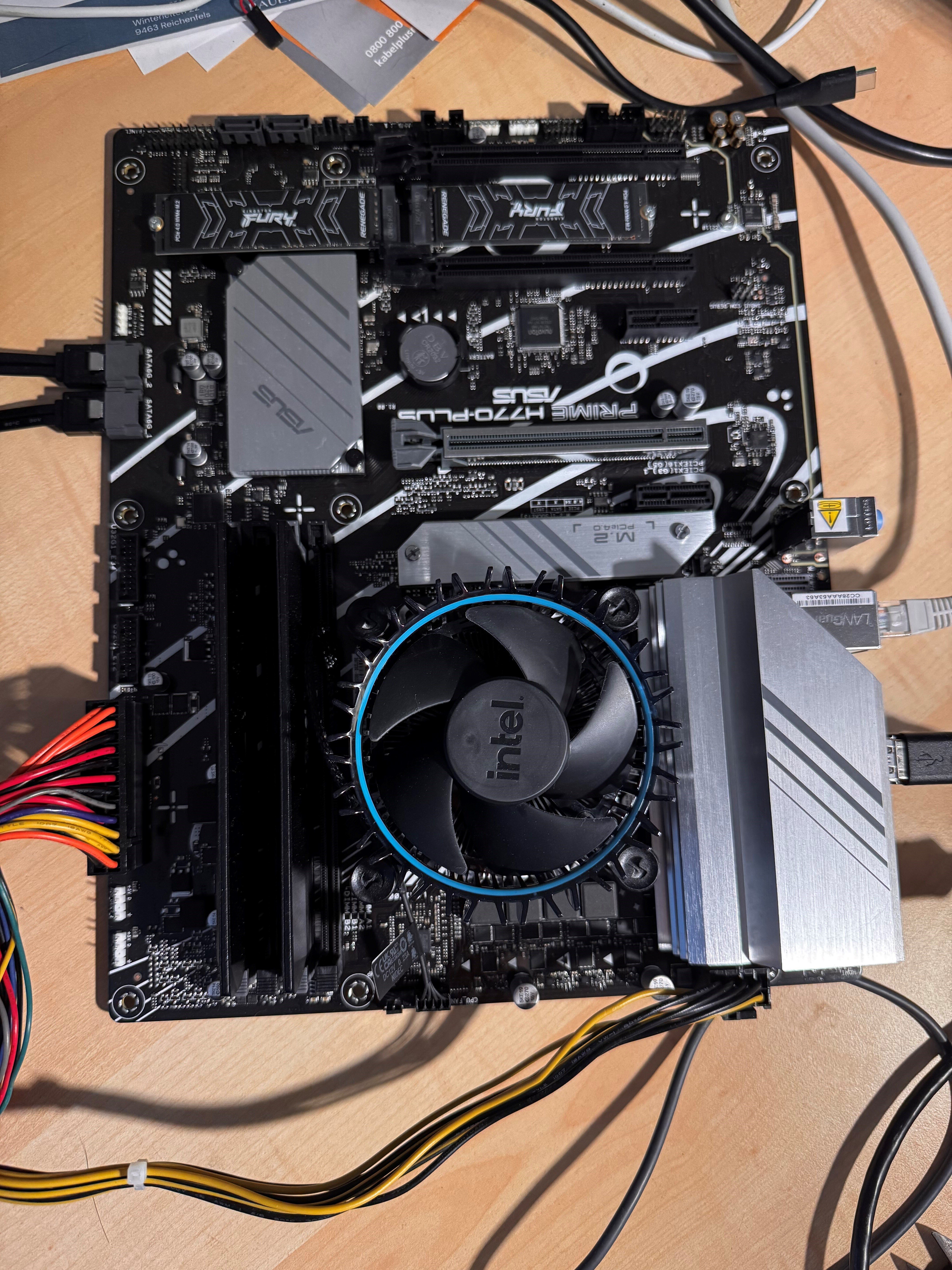

First here is my hardware setup:
Mainboard: ASUS Prime H770-Plus
CPU: Intel Core i5-14400
RAM: Crucial Pro DIMM Kit 32GB, DDR5
NVMe: 2x Kingston FURY RENEGADE SSD 2TB, M.2 2280 PCIe 4.0 x4
HDD: 2x Western Digital WD Red Pro 16TB

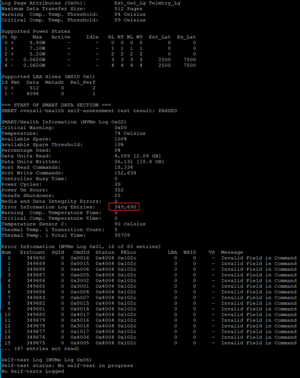

Another weird thing I noticed was the "Error Information Log Entries" value of the NVMe's. I retrieved that through smartctl on the cli.
When I boot the system from my live linux (Ubuntu) this value does not increment at all. When I boot Unraid without the SATA HDDs connected, this value does not increment at all. Only when I boot Unraid with the SATA HDDs connected this value is incrementing continuosly. Increamenting roughly by 30 every minute. See the screenshot above. It apears to me as if the operating system is trying to repetively send varios commands the NVMe with an invalid field. Unfortunately I couldn't find any information what is doing that or what invalid field there could be.

I would guess, that the OS continuosly sends commands to the device, what prevents the device from going into powersaving states and therefore creating the high temperature. By the way, the device doesn't show any other activity in Uraid or smartctl. The value "Data Units Written" nor "Data Units Read" aren't changing where as the "Error Information Log Entries" keeps going up.
After some searching, seems to be a common issue with those devices, though unclear why it doesn't happen with every OS, or just with disks connected with Unraid:
https://linustechtips.com/topic/1607748-random-nvme-error-logs/
https://askubuntu.com/questions/1460668/nvme-faulty-drive-smart-error-information-log-entries-fastly-increasing
