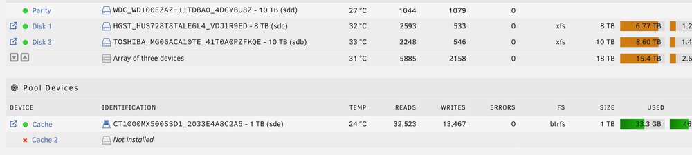

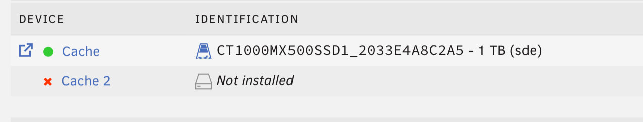

I added the NVME and it made it part of the existing ssd cache pool so I shut down the array and used destructive mode UD to delete the drive I then restarted the array and had a deleted drive listed showing 2 slots no option to go back to one. I removed the NVME physically and now I have a cache 2 not installed with a Red Cross device is missing disabled how can I remove it IMG_0526.thumb.jpeg.fb5390bcc0ecdd592fb5fe10019f54ce.jpeg

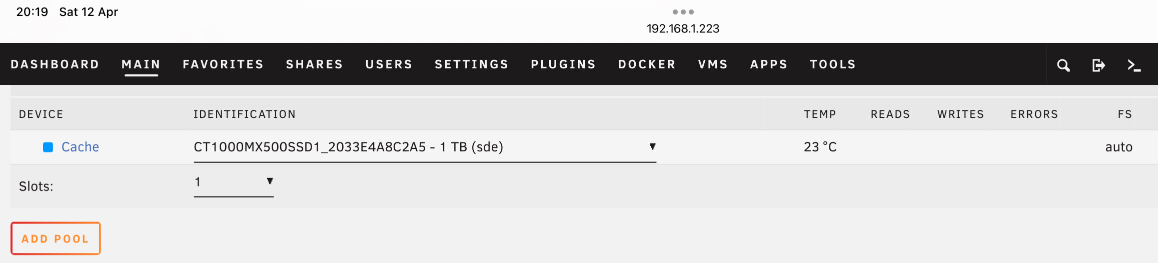

on main click on the first device for that pool and then "remove pool"

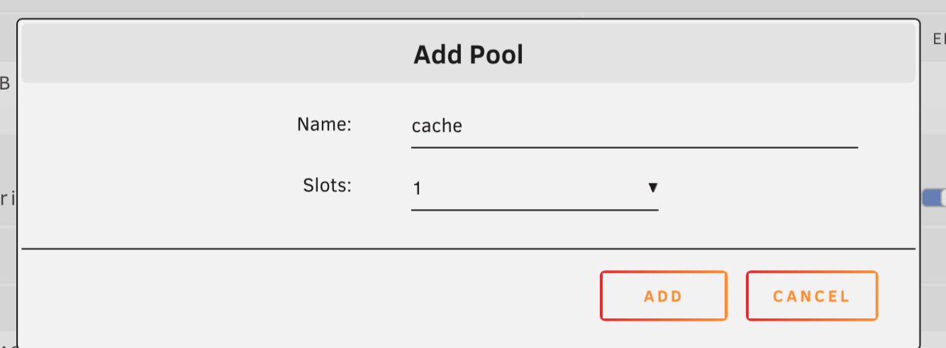

back on main, create a new pool with the same name and 1 slot
assign the pool device, leave the filesystem set to auto
start the array to import the pool

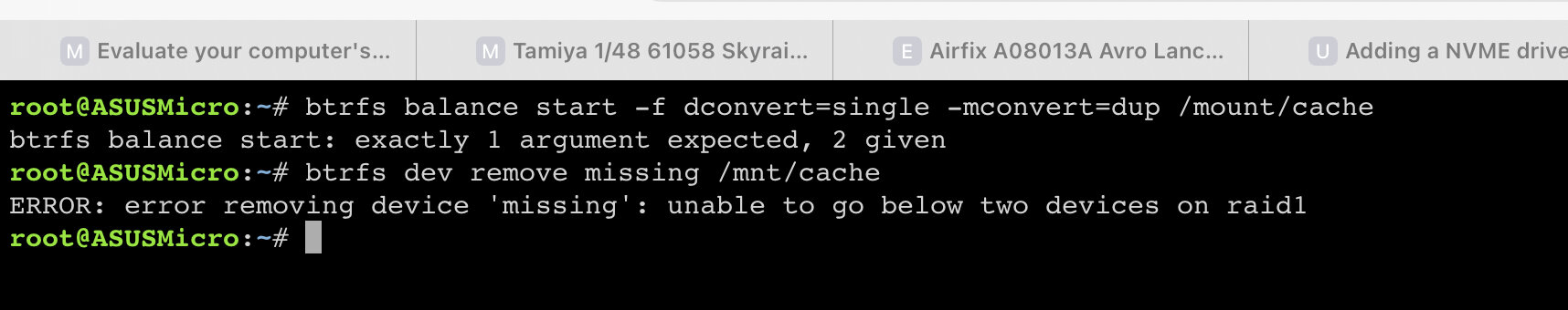

This is what I typed and this is what I get Unraid array is running
You missed a '-' before 'dconvert'. Try again.
Better if you don't type and just copy/paste

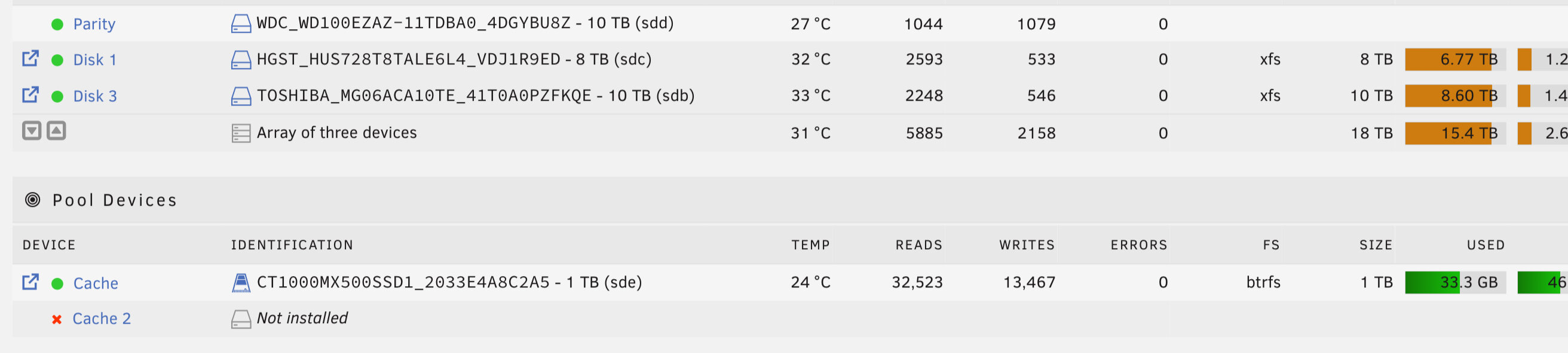

Ok I followed the instructions but when I start the array cache 2 not installed
Sorry, missed your post, post new diags with the array started, but that suggests you didn't run the 2nd command before reimporting the pool.
