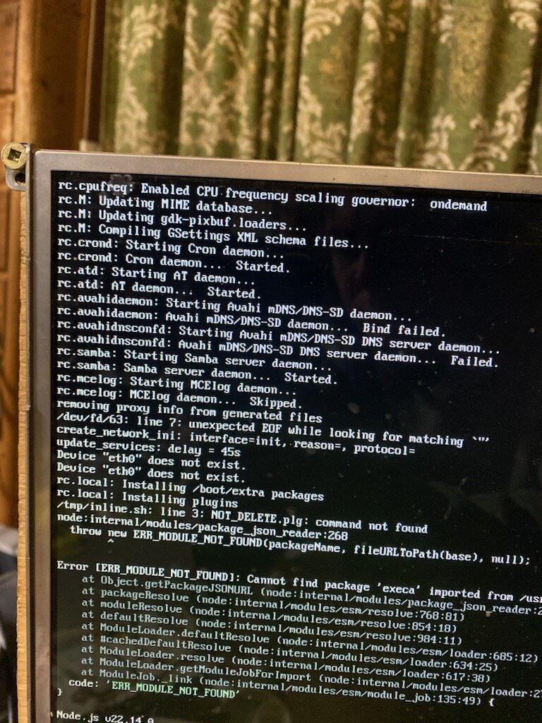

i downgraded back to 7.0.0 and lost network ip address
on my one server  i was having issues with the UD Devices plugin  showing  drives unable to mount..  so i decided to downgrade from 7.0.1  to 7.0.0

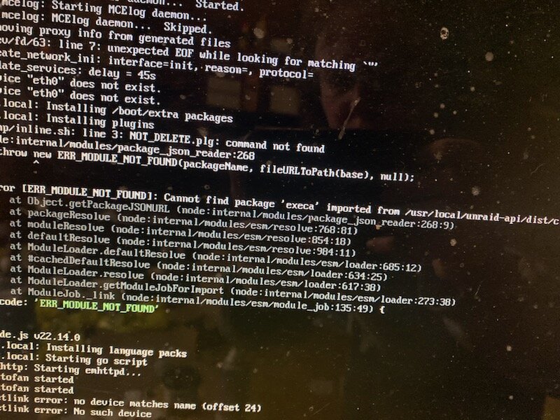

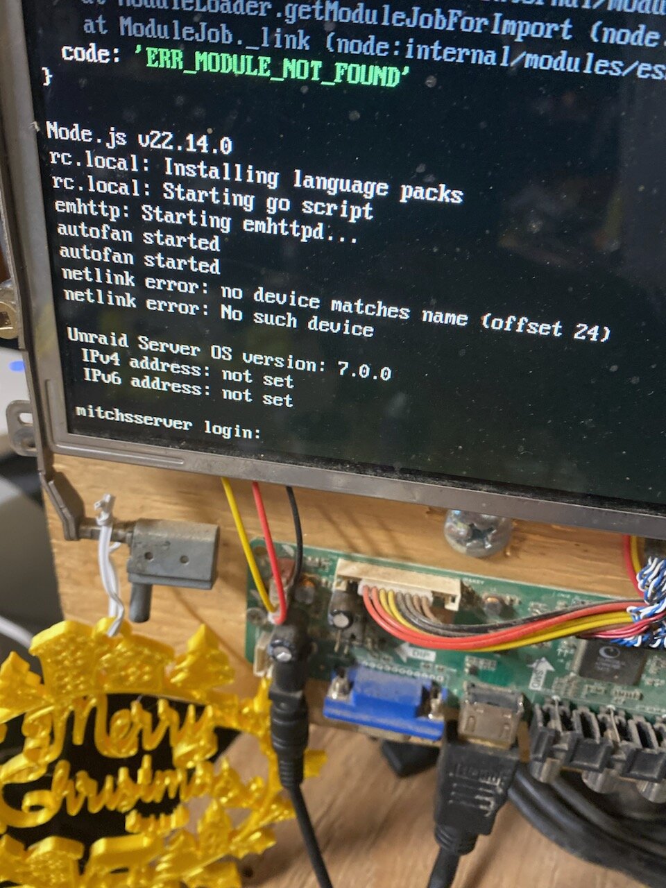

i did and rebooted.. and it never recovered.. it boots up  and login but ip is always 169   i tried editing the network.cfg to set a static ip  and still got 169  i tried deleting the network.cfg  same issue  but there is some errors above the login  i wondering if it corrupted downgrading?
766168241.thumb.jpg.1329cb98d325c80d042bc44b6bb6093f.jpg766168230.jpg.de55898a3c91855b26202293865a0872.jpg766168230.jpg.de55898a3c91855b26202293865a0872.jpg

25:00.0 Ethernet controller [0200]: Realtek Semiconductor Co., Ltd. RTL8111/8168/8211/8411 PCI Express Gigabit Ethernet Controller [10ec:8168] (rev 15)
	Subsystem: Micro-Star International Co., Ltd. [MSI] Device [1462:7a40]
	Kernel modules: r8169

You will probably have to boot that Unraid flash drive on another computer that has access to the internet to install the plugin from the Apps page. You need rtl8169
You need the plugin for
so i had the right plugin installed in the first place then
so i have to re install it.. it is working now  with 8125 from the link you sent..
downgrading didnt fix the UD issues  so i guess its a new bug ..
so maybe cuz i deleted the r8168 plugin it made it work? as i back up and running

im guessing it might be the plugin how it has changed  in the plugins folder it used to be
r8168.plg   but when i reinstalled it  it is now  unraid-r8168.plg  and also has its own sub folder r8168-driver..maybe cuz things changed caused the issue
lease its working now
