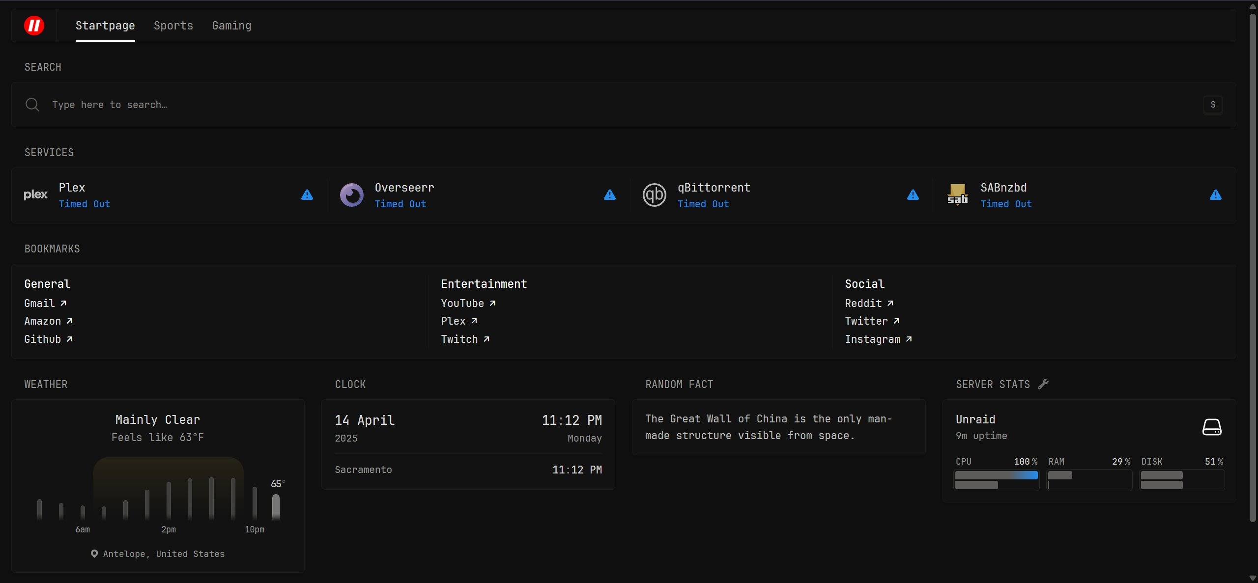

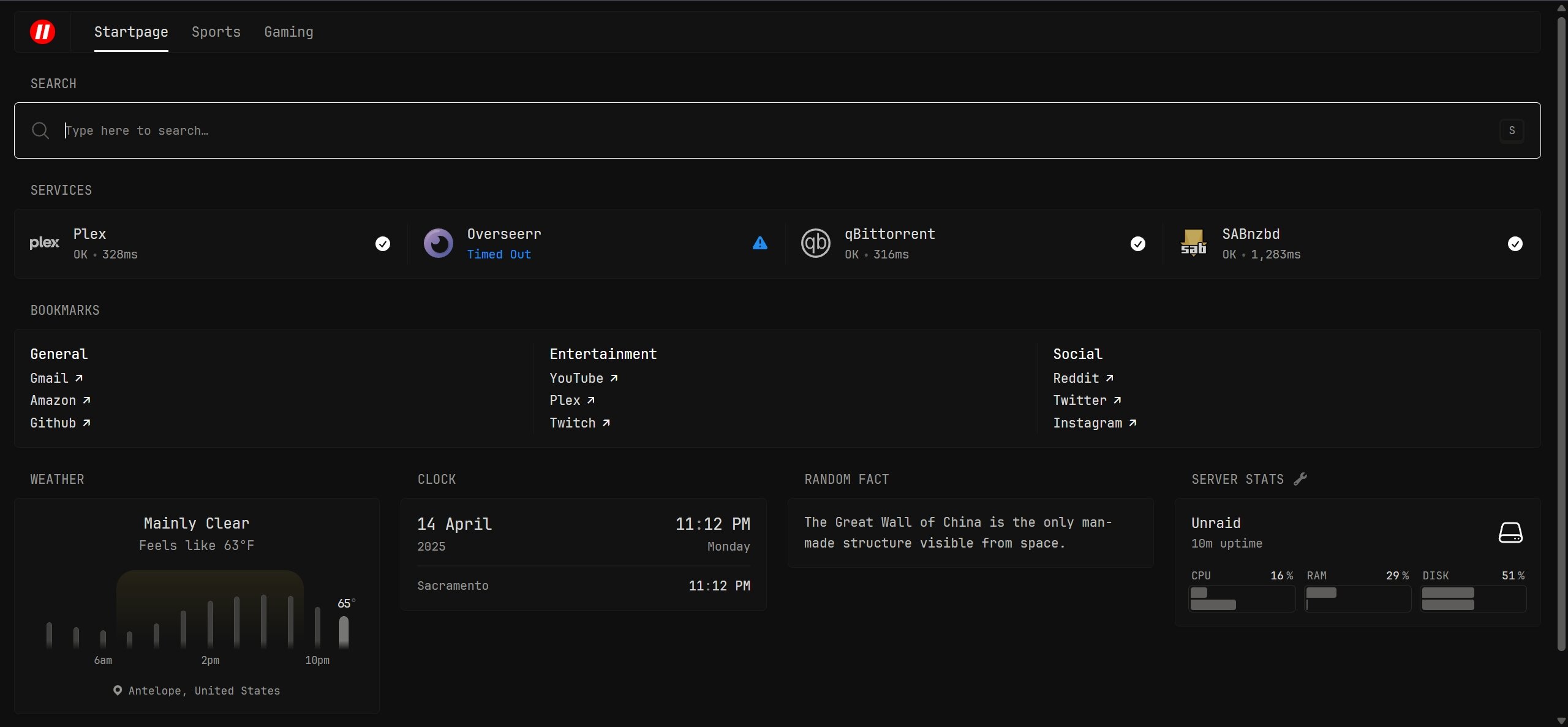

I noticed containers would not load for a while. A visual example I noticed this with was with my glance home screen where it would report services as timed out, when normally they'd hover around the 200ms range.
Here is a what it looks like after I refresh after a few seconds

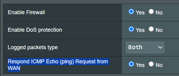

Fixed! Dont exactly know what this setting does and why it messes up my network, but enabling it fixed all my issues.
EDIT: Nope. Nvm. That did not fix it
EDIT EDIT: Seems like setting Logged packets type to none fixed it? Might be time for a new mesh network...
