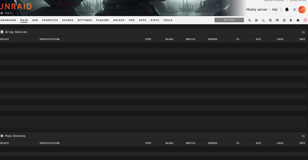

Strange new error... no info visible in main screen and array is not mounting either.
Was working just fine 5 min ago, just did a reboot and then i got this. Same happend last night and i did a new reboot and it was ok. Now its not going ok it seems

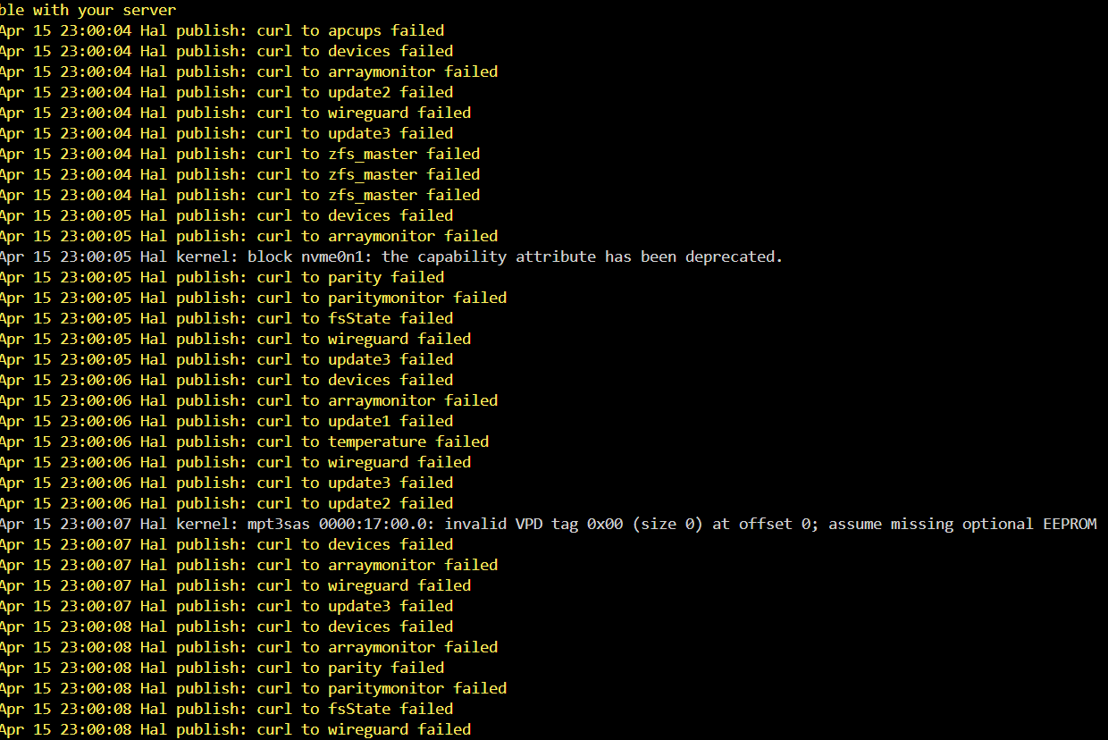

also log is full of these

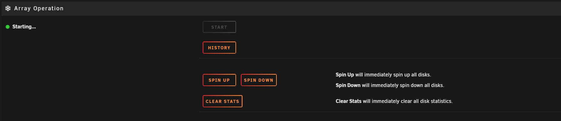

i did a /etc/rc.d/rc.nginx restart and then the main information is back, but the array is still starting status
But its not really working. cant press any buttons like spin down drives etc on the main page

Any idea what "publish" is? That isn't something built-in making those log entries.
