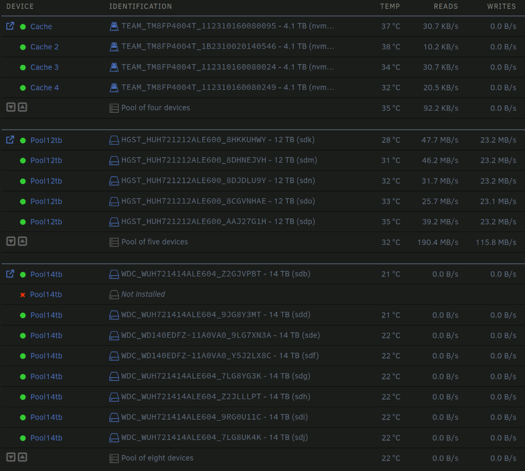

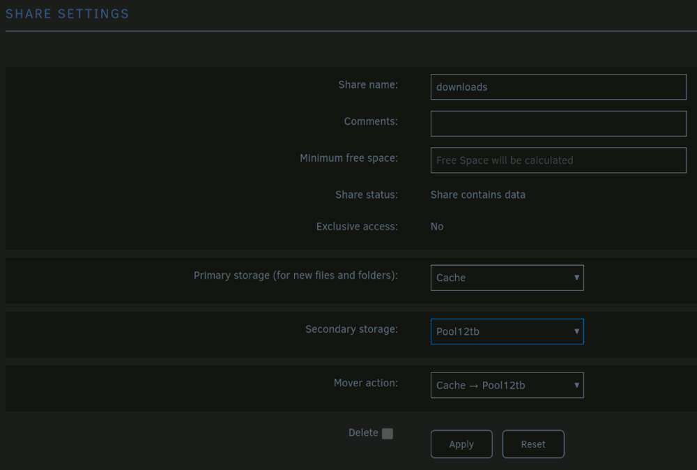

Attached is a screenshot of my current setup. I understand my server is slow because almost nothing is using my SSD cache pool but hitting the disk arrays directly; my 4 NVME drives are being ignored, so sad. The reason for this is two-fold:

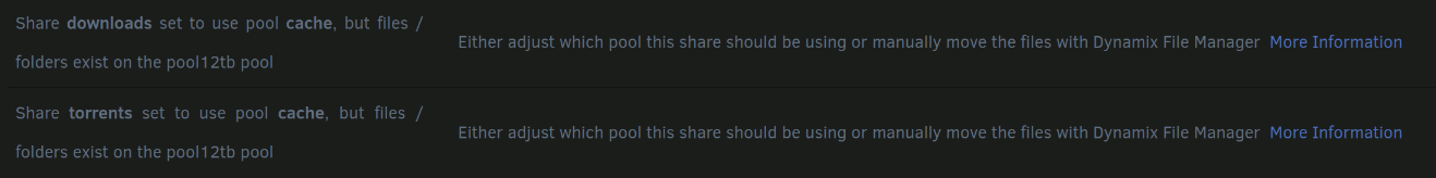

1. The Fix Common Problems plug-in would report an issue with the share being set to pool12TB but files existing on cache and needing to be moved.
2. When connected via NFS, I would receive messages about the file/directory had gone away, bad/changed fd (file descriptor?), and other nuisances making the share unusable.
Is there any way to be able to get the benefits of the SSDs on the two disk pools? I am happy to change the setup to different filesystems and/or configurations to get better performance.

12 minutes ago, JorgeB said:
That should only happen if the share is misconfigured.

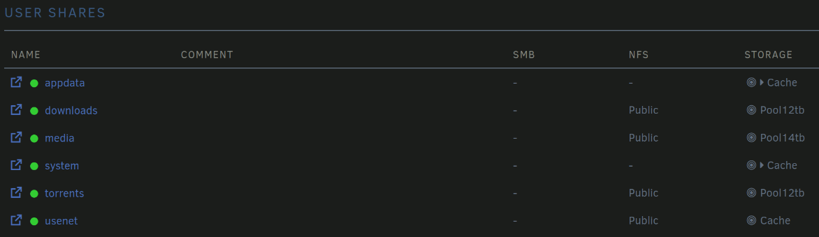

For the share issue I have attached a screenshot of the configuration that was used. Can you advise what the misconfiguration would be?
That looks OK, post the diagnostics.

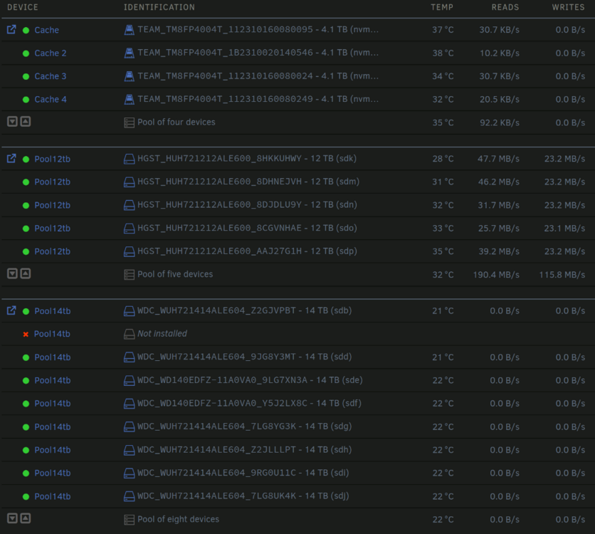

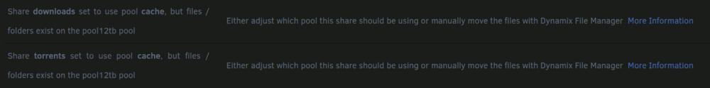

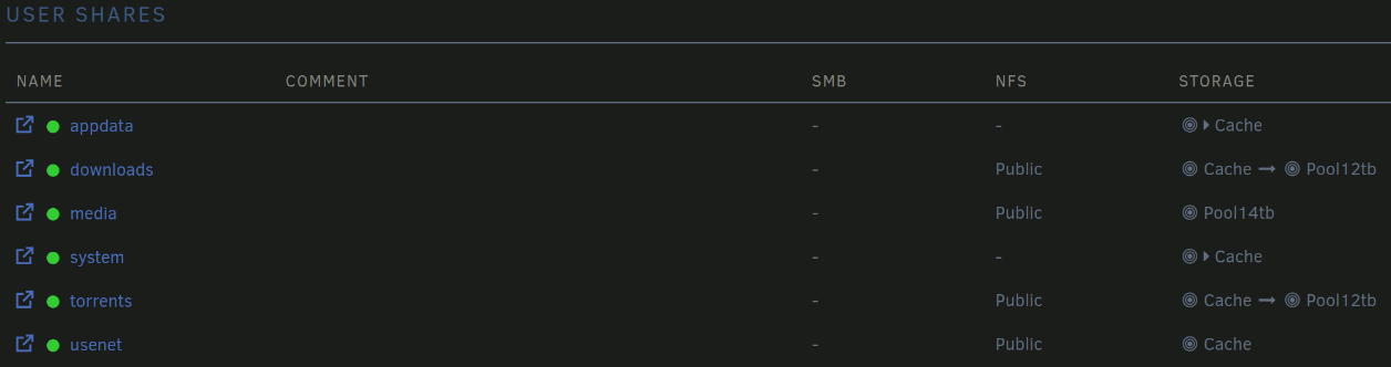

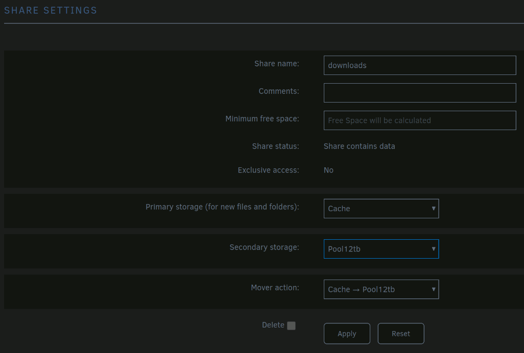

Diagnostics and updated screenshots attached.

Apr 16 09:57:24 nasXD root: Fix Common Problems: Warning: Share downloads set to use pool cache, but files / folders exist on the pool12tb pool ** Ignored
This looks like a FCP bug, probably still doesn't allow for shares with pools as primary and secondary, recommend making a report in the existing plugin support thread.
