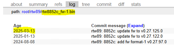

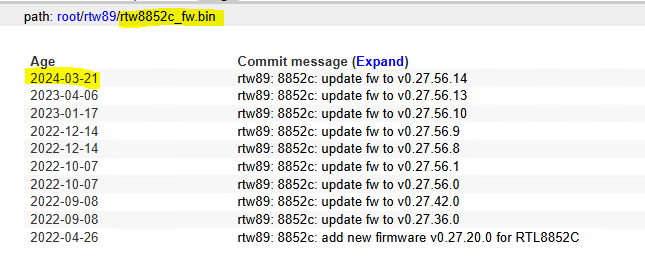

So the issue is the current firmware from Realtek for this adapter, the firmware that comes stock with Unraid (and Linux), is the one from the same site you got the other one, but the one ending in -1, since it's the latest available one:
The one that you are using and works is from 2024:
So hopefully Realtek will fix this in a future update, LT may also allow the stock firmware to be overwritten in a future release to help deal with similar issues.
