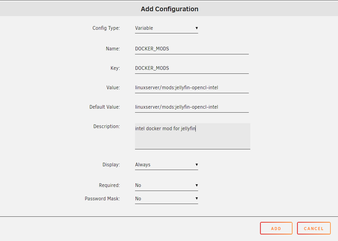

to use graphics decvies in dockers, the docker them selves need the driver software..
You can try using a intel driver docker mod...
-e DOCKER_MODS=linuxserver/mods:jellyfin-opencl-intel

for the docker mod, do I just put that in "extra parameters"?
yes
otherwise make it apart of the unraid web ui template:

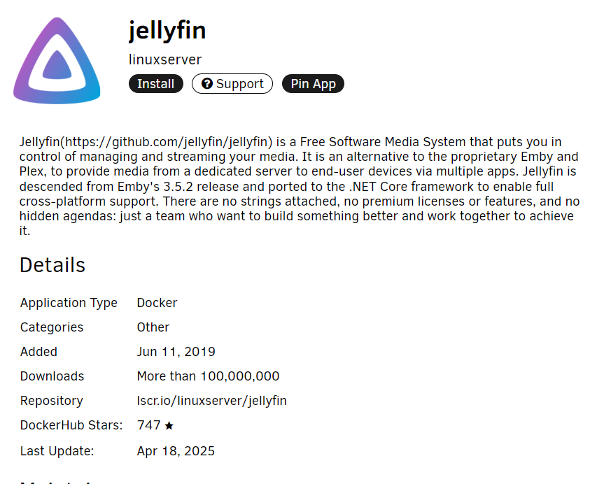

while this can work for other dockers. Since this is a linux io / linux server docker mod... I can guarantee better results running linux server jellyfin docker found in the CA:
I'll try the mod first since it's all setup already minus the transcoding issue. I'm running the bbergle "official" docker
Okay, the mod didn't work on the bbergle docker but it did work on the Linuxserver one.
