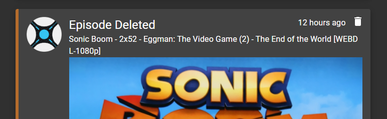

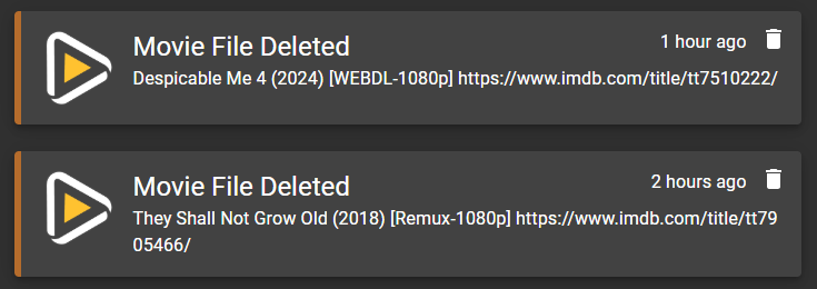

Not sure what messages you are referring to?
Your diagnostics show that you have filesystem level corruption on disk 4 so you should run a check filesystem on that drive.   It might also be a good idea to run memtest as RAM issues can cause corruption.
12 minutes ago, Vitor Ventura said:
starting receive messages that some series and movies is being removed.
Do you have an example? This is not something that Unraid does so it must be some application.
I use Gotify, connected to Sonarr and Radarr, thats why.
And which of those is giving you the message?
Can you tell us the exact contents of the message?
Maybe it's telling you it is removing them from its database because the files aren't accessible. And they aren't accessible due to corruption.

Yes i confirm, that its been removed from the DB, because, cant access to the files due to corruption.

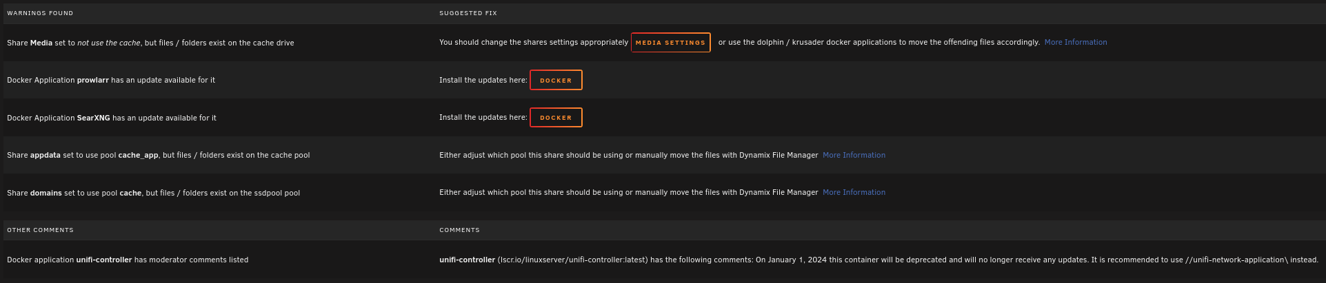

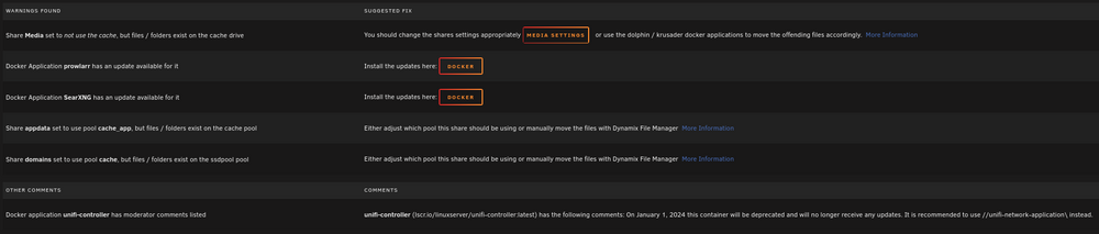

Install Fix Common Problems and let it scan. I have mine configured for daily scans.
Then we can talk about what it finds.
As you can see, Media has files on cache that will not be moved. Set it to Primary:cache; Secondary:array; Mover Action:cache->array. If you want to set it to not use cache after you get those files moved off cache that's up to you.
Unraid v7 will move between pools. But nothing can move open files, so to get appdata and domains moved you have to go to Settings - Docker and disable, and Settings - VM Manager and disable.
Set those shares appropriately so they will be moved to whichever pool you want.
I'll let you decide if you want to update those dockers.
