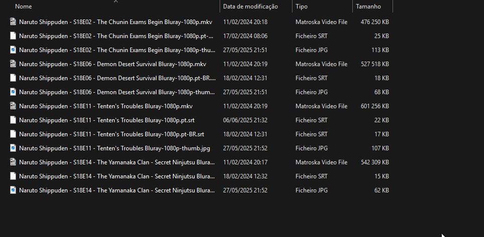

After all the work, some series (i received notification that had been deleted) didnt shows up, so i ran Compute All and have 667Gb of data in lost+found.
How can i recover that data, if i cannot access?

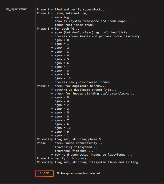

lost text
ran via webUi multiple times

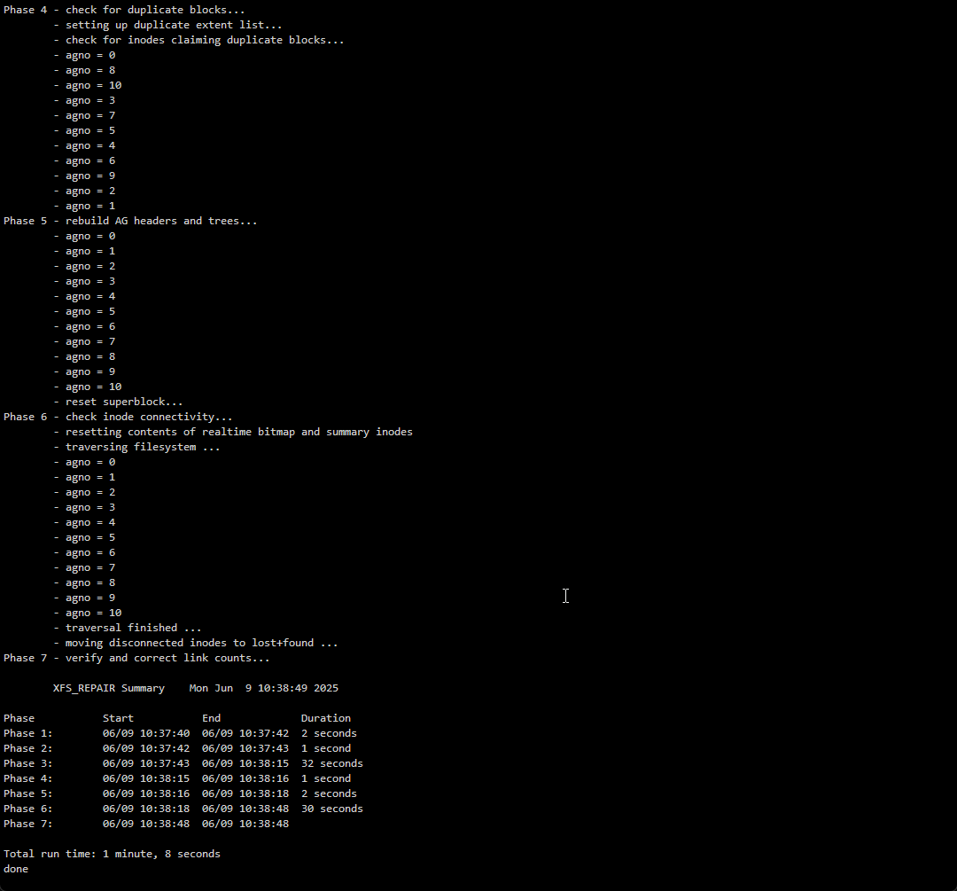

ran xfs_repair -L and then -v, nothing changed

The folder is giving invalid path error is the lost+found folder.
i had lost files, example, i had the season 18 completed of Naruto Shippuden
is not possible to recover all files in lost+found?
Files are put into lost+found when the recovery process cannot find the directory entry to give them their correct name. If you want to try and recover them then it is a manual process to look at each in turn to work out what name it should have, although the Linux ‘file’ command can help by telling you at least what the content type is for a given file.
You will probably need to run Tools->New Permissions on the lost+found share if you want to be able to access the contents over the network.
