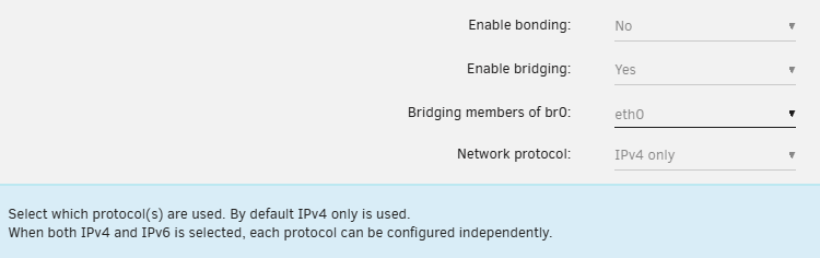

1. Unriad network settings.
Network protcal needs to use both IPV6 and IPV4

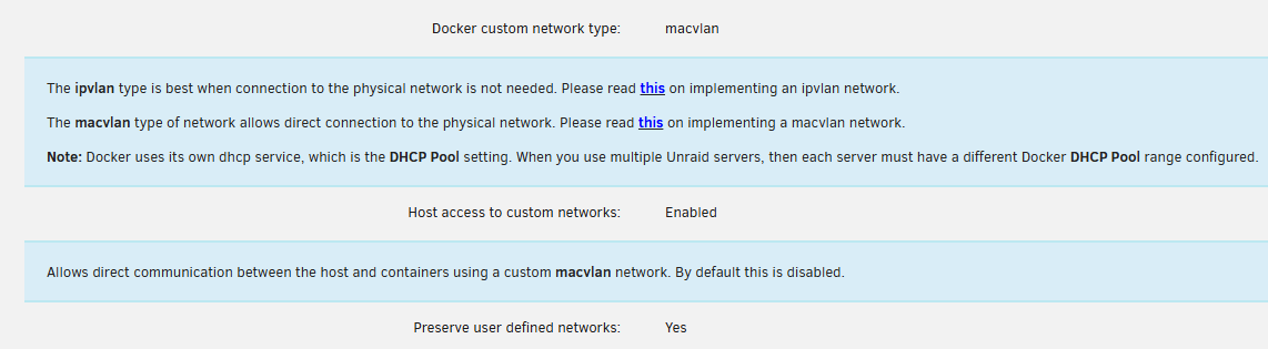

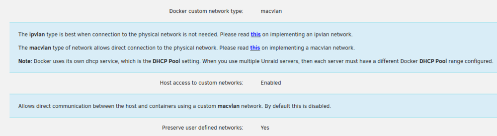

2. secondary docker settings for bridge...
Settings > Docker
-You want host access enabled and preserver. I prefer macvlan over ipvlan with is fine... some docker need adational lan idenity.

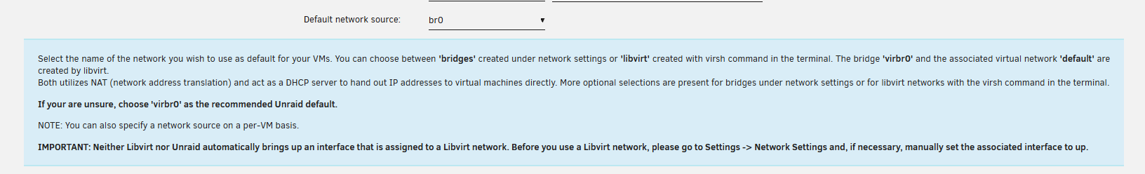

3. VM settings regarding network
Setting > VM Manger
note the Default Network Source.
it may say vhost0 ... You don't want to be on virbr0 as that will tell VM to use the libvirt internal dhcp and router and be given a dhcp IP from the VM hyper-V virtual switch/router....
