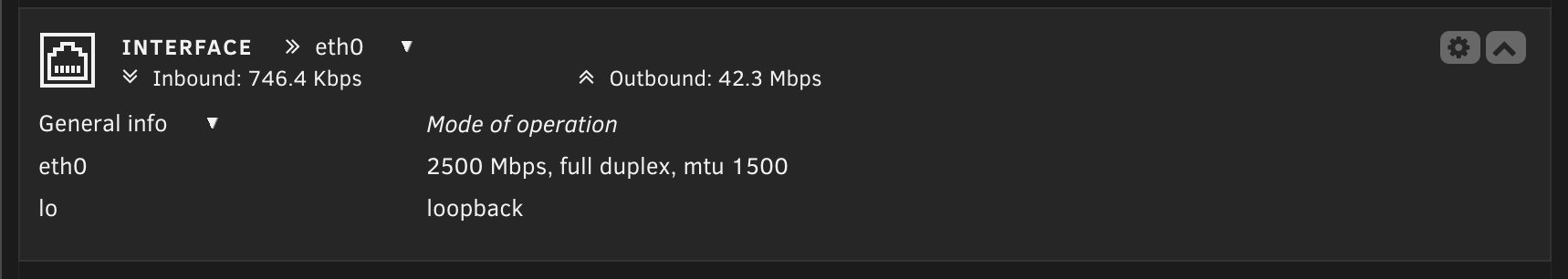

Network:
eth0: 2500 Mbps, full duplex, MTU 1500, connected directly to the router/switch

Yes, this happens regardless of whether I'm saving directly to the disk share or to the regular shares. Could it be an issue with my router? Maybe the built-in switch is the bottleneck because of all these crappy all-in-one features? I'm using a FRITZ!Box 6660 Cable. Or should I try a different network driver instead?
Start by running a single stream iperf test, also run reverse direction (-R).
