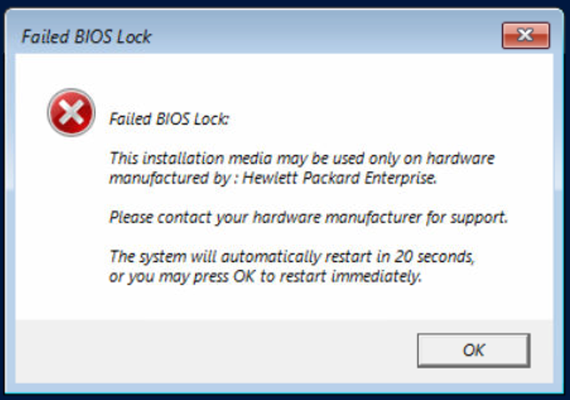

Start the VM, boot from iso then see the attached image
"This installation media may be used only on hardware manufactured by : Hewlett Packard Enterprise."
Ok so we need BIOS passthrough from the 'metal' to the VM... how?

Hi All,
Answering my own question
Edit the VM and change to XLM view and add `<smbios mode='host'/>` in the `<os>` section.
  <os>
    <type arch='x86_64' machine='...'>hvm</type>
    <loader readonly='yes' type='pflash'>/usr/share/qemu/ovmf-x64/...</loader>
    <nvram>/etc/libvirt/qemu/nvram/...</nvram>
    <!-- Add this line to pass the host BIOS to the VM -->
  </os>
This should really be easier to find...
Hope this helps
