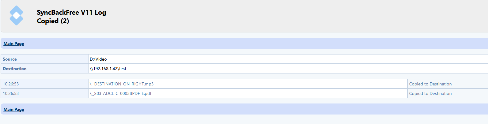

I have no issue syncing files with the names from your example form Windows to Unraid with SyncBackFree, suggesting Unraid is not the issue:

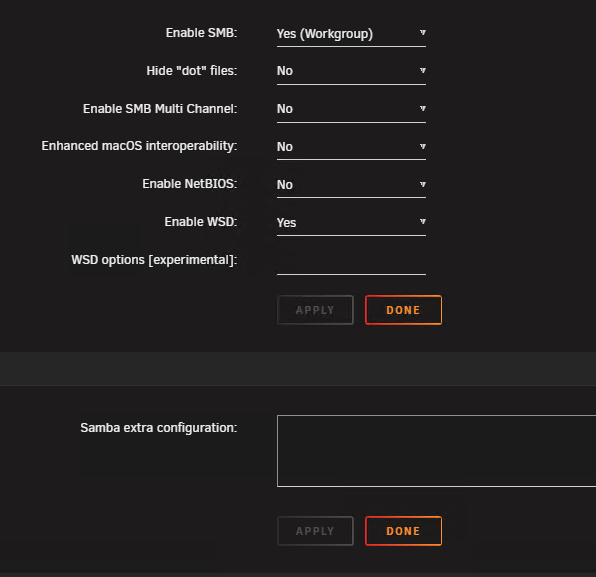

Do you have any custom settings on Samba extras? These were the SMB settings I used, share was a public share:
My SMB settings are just like yours except Macos Interoperability is Yes.  That must be a new default, because I didn't change it. I do not have any MacOs on my network.  I'll try changing it to No and see if it solves the issue.
Edit - I checked it right after restarting the array after making the change of "Macos Interoperability" to No.
It still failed.
I tried again a couple of hours later, and now it works. I am able to copy files starting with "_." to the Unraid share.
