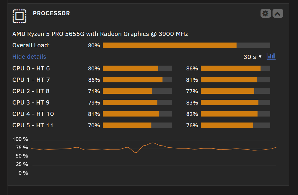

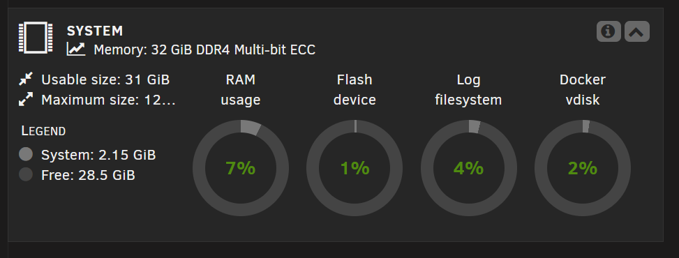

So what is going on? Am I doing something wrong? I'd understand the slow write speeds if I had a parity disk, but that's not the case. There's also plenty of free memory, although my CPU seems to have suspiciously high usage.

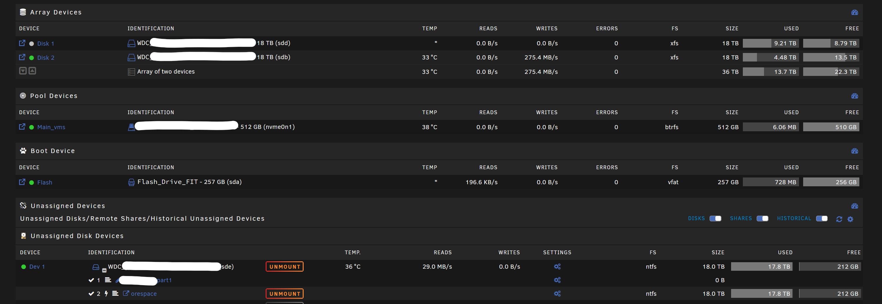

This shows the actual speed the drive is writing at:
Does that speed remain constant or does with go to zero sometimes?

It does go to zero sometimes, but just for a few seconds. Then it picks back up to around 275 MB/s again. The amount of time this transfer is taking does not match that write speed sadly. The read speed from the source drive matches the reported transfer speed as well. I wonder what causes that difference?
This means your IO queue is overloaded (Data coming in is faster than writing speed, first data is buffered in RAM but after this is full, there is no way to continue. So it stalls, waits until the RAM is written out and then continues) This looks like repeating Waves, and it is normal.
Writing takes much more times, not for the physical transfer only, but after the file is complete, the directories need to be updated and rewritten too. This includes a lot of additional writes and stepping. The smaller the files are, the more it will slow you down.
Nothing you can do against it, be patient.
This is due to IOWait being represented in the CPU load. If you open the terminal and type in
top
  you will see the statistic for "wa" higher than 1.0 seen here:
IOWait is basically CPU waiting on the disk to complete it's tasks before it can resume doing CPU things.
