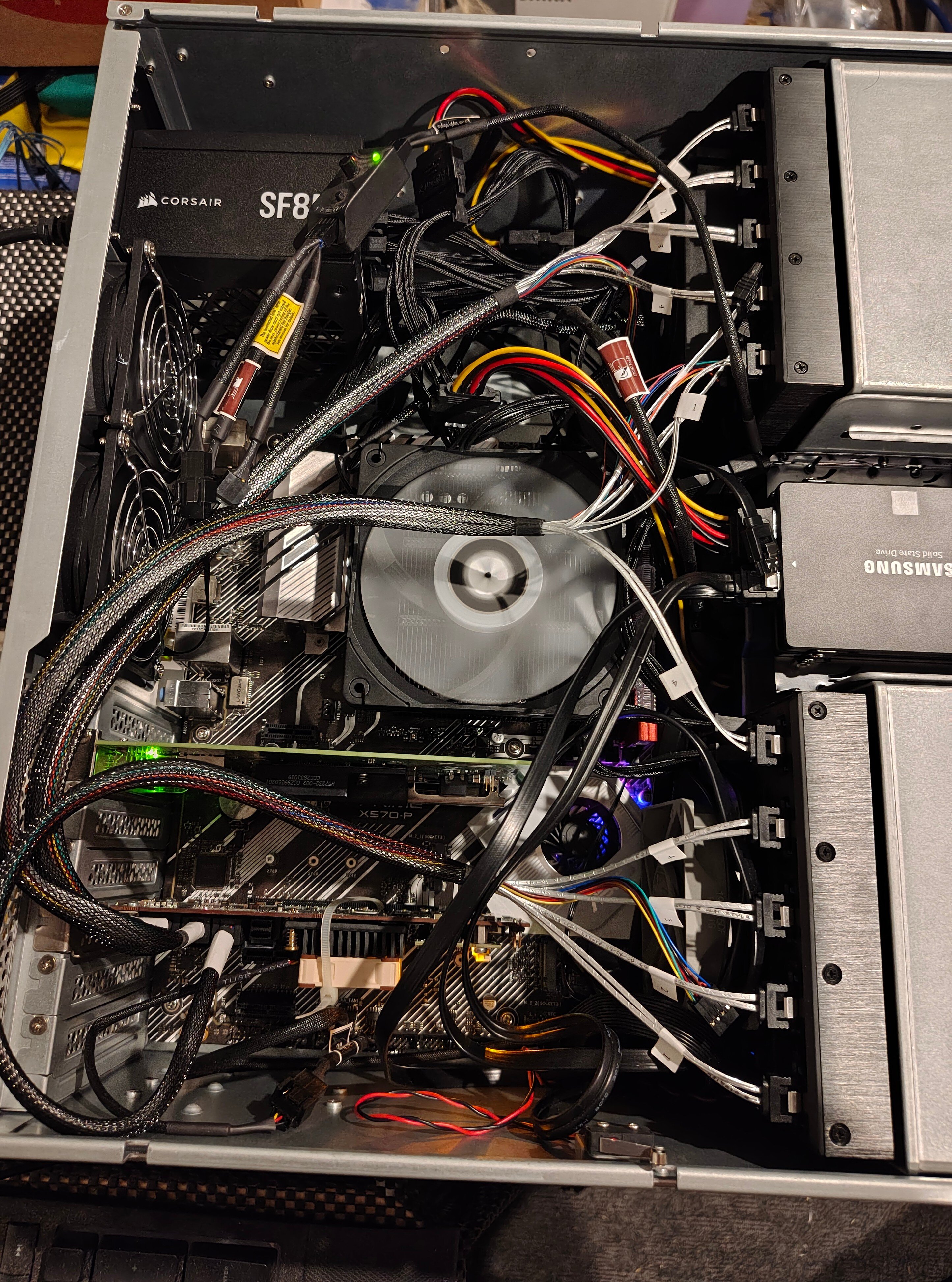

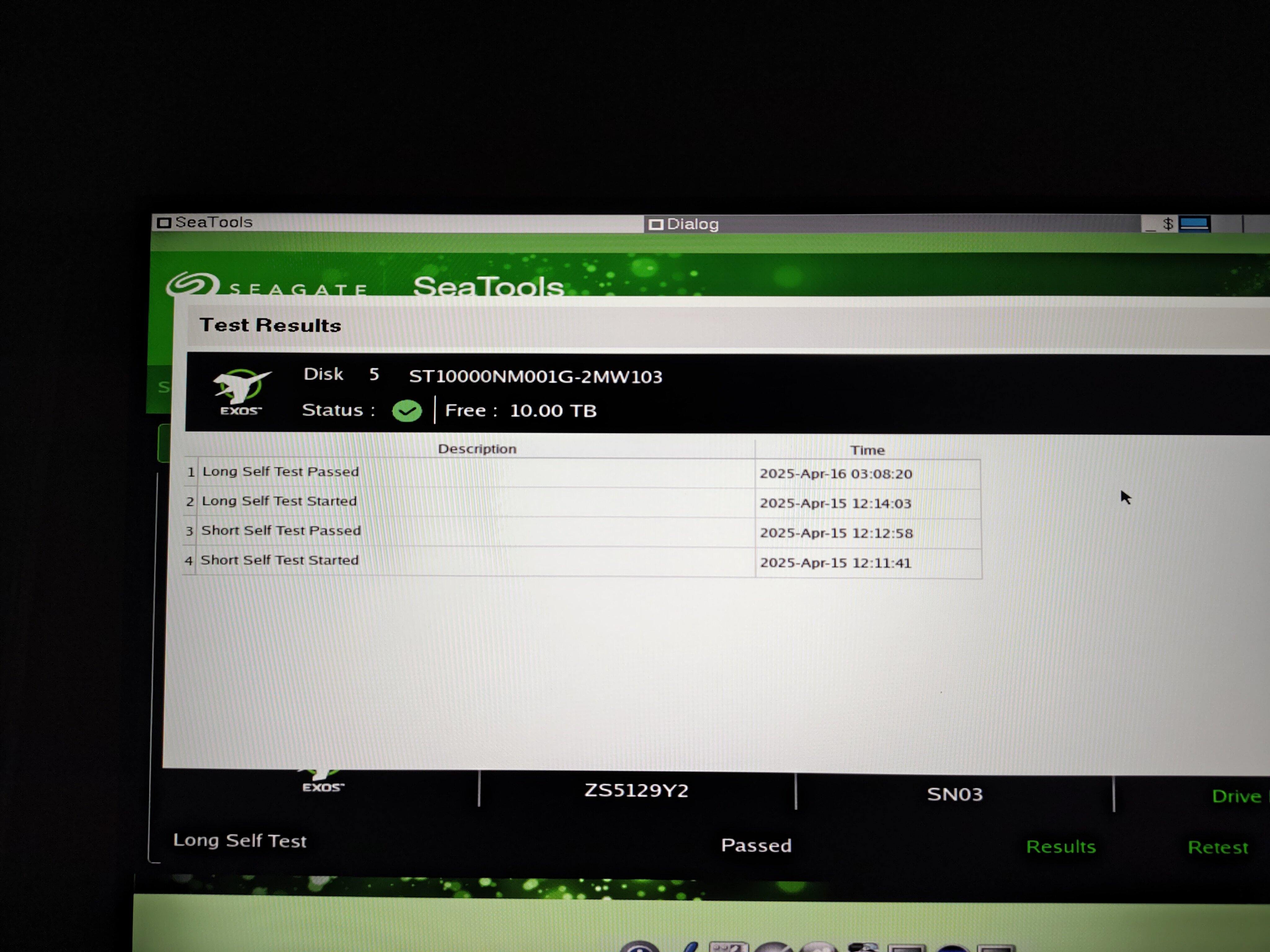

Recently moved my build into a rackmount case, swapped out my LSI 9201 HBA for an Adaptec 71605 (with brand new store bought Silverstone cables), and hooked everything up. Everything has been going well, but I have noticed that when I'm sitting idle in UnRaid (as in, not doing a parity check or transferring files) one or two of my disks are being pinged every second. It's like I'm sitting in a room with an old clock. At first, I thought maybe something was wrong with the drive - so I did extended SMART tests on all of my drives (within UnRaid), and also loaded up Seagate's SeaTools to run more long tests on my Seagate drives, with every drive passing with flying colours. I then noticed that the noise synced with the HDD activity LED on my disk enclosure (SilverStone FS305-12G), holding my array drives (2xBarracuda Pro 10TB, 2x Exos 10TB, and 1 WD Red Plus 12TB (Parity)). The disks in my second FS305-12G, holding a RAIDZ1 ZFS pool (All 3TB WD Red CMR drives), never get pinged with this activity, so it has something to do with activity hitting the array.
I've tried to capture a video of it, not the easiest to hear since there are a bunch of case fans blasting away.

(Edit: I've included one of the SeaTools Test Result screenshots, but all of my Seagate drives had the same results, and the lone WD Red Plus 12TB in the array passed an extended Smart test within UnRaid)
